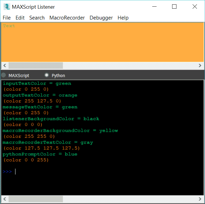

inputTextColor
Lets you get and set a Color value defining the color of typed input text in the Scripting Listener.
messageTextColor
Lets you get and set a Color value defining the color of error message text in the Scripting Listener.
listenerBackgroundColor
Gets or sets the background color of the Scripting Listener. When this value is changed, the caret color changes between black and white as necessary to remain visible. Available in 3ds Max 2020 and higher.
macroRecorderBackgroundColor
Gets or sets the background color of the macro recorder pane. When this value is changed, the caret color changes between black and white as necessary to remain visible. Available in 3ds Max 2020 and higher.
macroRecorderTextColor
Gets or sets the color of text in the macro recorder pane. Available in 3ds Max 2020 and higher.
pythonPromptColor
Gets or sets the color of the prompt in the Scripting Listener when it is in Python language mode. Available in 3ds Max 2020 and higher.
macroRecorderSelectionForegroundColor
Gets or sets an override color value for selected text in the macro recorder. A value of 'undefined' means the default setting is used. Available in 3ds Max 2020.1 Update and higher.
macroRecorderSelectionBackgroundColor
Gets or sets an override background color value for selected text in the macro record. A value of 'undefined' means the default setting is used. Available in 3ds Max 2020.1 Update and higher.
macroRecorderSelectionAlpha
Gets or sets an override alpha channel (translucency) for selected text (foreground and background) in the macro recorder. This value is in the range of 0 to 255. A value of 'undefined' means the default setting is used. Available in 3ds Max 2020.1 Update and higher.
listenerSelectionForegroundColor
Gets or sets an override color value for selected text in the Scripting Listener window. A value of 'undefined' means the default setting is used. Available in 3ds Max 2020.1 Update and higher.
listenerSelectionBackgroundColor
Gets or sets an override background color value for selected text in the Scripting Listener window. A value of 'undefined' means the default setting is used. Available in 3ds Max 2020.1 Update and higher.
listenerSelectionAlpha
Gets or sets an override alpha channel (translucency) for selected text (foreground and background) in the Scripting Listener window. This value is in the range of 0 to 255. A value of 'undefined' means the default setting is used. Available in 3ds Max 2020.1 Update and higher.
outputTextColor
Lets you get and set a Color value defining the color of output text in the Scripting Listener.
EXAMPLE
