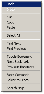

This is the default context menu which appears when you right-click in the Editor window:

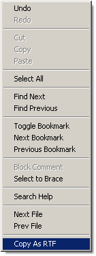

Right-click in the Editor- the new separator and new menu item should appear!
Select the item "Copy As RTF" to copy the selected text to the clipboard including all formatting.
