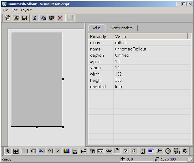

Visual MAXScript is a direct-manipulation, multithreaded, forms-based editor that you can use to layout and edit MAXScript rollouts. Rollout scripts can be created from scratch in the forms editor, or use it to interactively edit and add to an existing rollout definition in a script editor window.
The layout editor can be accessed in two ways:
When accessed as a Utility through the Utility command panel, the layout editor operates in a "standalone" mode. Any forms created can either be exported as separate script files containing the rollout definition script or saved in a special .vms binary layout file that can be opened again by the Visual MAXScript utility. When used in this mode, any script files exported can be opened in script editor windows for further editing in MAXScript or merging with other script files.
When accessed through the new script editor Edit menu items, the layout editor is designed for application to rollout definition sections in the active script editor. The "New Rollout" menu item is used to create a rollout definition from scratch. You place the cursor in the edit window where you want the newly-generated rollout code to be inserted and choose Tools>New Rollout. This opens the editor on a blank form to which you can add and arrange and edit rollout items. Choosing File>Save or hitting the Save icon in the layout editor window will cause the script for the rollout to be inserted at that point in the editor window. Subsequent edits and saves while the layout editor is still open cause that inserted code to be updated.
The "Edit Rollout" item (hotkey F2), is used to edit an existing rollout definition in the active script editor. You place the cursor anywhere inside a rollout or utility definition, choose Tools>Edit Rollout (F2), and the layout editor is opened showing that rollout. You can edit and add to the rollout in the layout editor and when you choose File>Save or click the Save icon in the layout editor, the original definition is replaced with new code corresponding to the edited rollout. Subsequent changes and saves while the layout editor is still open cause that code to be updated each time.

When you first edit or create a rollout in the layout editor, it defaults to the standard width for Command Panel rollouts. You can adjust this width in the editor by resizing the outer gray rectangle and the editor emits width: and height: parameters on the generated rollout header. You can edit these numbers in the script editor and they will be honored by the layout editor when you next edit that rollout.

You add new UI items by clicking its button in the item toolbar at the bottom and then dragging out a rectangle for it in the main form. You can select an existing item and edit its parameters in the property list on the right. You can select multiple items by fence-dragging or ctrl-clicking and perform various alignments operations, see the Layout menu. A selected item can be deleted by clicking the red X toolbar button. The various panes can be resized or even torn off if you want to customize the editor layout.

A new custom item type has been added to the item type toolbar at the bottom of the VisualMS dialog, allowing custom items to be created from scratch in the editor. Its icon appears in the toolbar as a face in profile. When first created, the item class parameter in the parameter list shows as '???' and must be edited to contain the desired custom item type.
An ActiveX control rollout item type is available in MAXScript. The icon for it appears in the UI item toolbar at the bottom of the VisualMS dialog, as a dot array with the word OLE superimposed. See ActiveX Controls in MAXScript Rollouts
