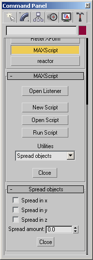

Here is a short example that implements a utility for spreading the positions of the objects in the current selection. It installs a Spread objects entry in the Utilities list. When opened, the Spread objects rollout has three check boxes and one spread amount spinner. The spread spinner event handler is called whenever the user adjusts the spinner, and the event handler expression computes a new position for the objects in the selection, testing the state of each check box to control the spread.

The Utilities panel rollout created by the previous script looks like the following figure. The Close button is automatically created by MAXScript in the utility rollout, and closes the rollout.
