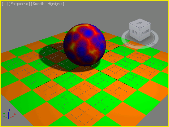

Developing a Simple Render To Texture Script
The following example shows the basic steps to create a custom Render To Texture script.
The script creates a simple scene containing a textured sphere on a textured plane lit by a shadow-casting omni light.
Then it bakes the Diffuse and Lighting Elements of both objects to TGA files on disk and creates a Shell Material containing the old material in the one slot and the baked material in the other.
The Baked material uses a Composite map to combine the diffuse and the lighting information into a single diffuse map.
In this simple case, the texture coordinates of both objects are procedurally generated by the geometry primitives and are usable for baking. Also, no projection mapping is required in this simple case.

RESULTS
After running the script, the following four baked textures will be written to the Images folder and will appear on the scene objects in the viewports:
