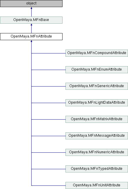

+ Inheritance diagram for OpenMaya.MFnAttribute:

Detailed Description
Base class for attribute functionsets.
Method resolution order:
-   MFnAttribute
-   MFnBase
-   builtins.object
Base Class
