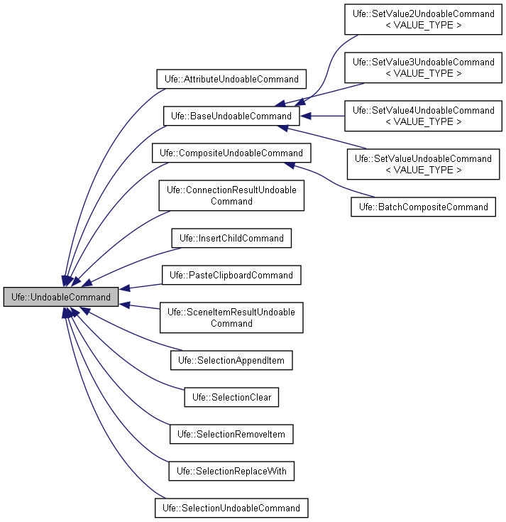

Inheritance diagram for Ufe::UndoableCommand:

Reimplemented in Ufe::AttributeUndoableCommand, Ufe::SetValueUndoableCommand< VALUE_TYPE >, Ufe::SetValue2UndoableCommand< VALUE_TYPE >, Ufe::SetValue3UndoableCommand< VALUE_TYPE >, Ufe::SetValue4UndoableCommand< VALUE_TYPE >, Ufe::PasteClipboardCommand, Ufe::SelectionAppendItem, Ufe::SelectionRemoveItem, Ufe::SelectionClear, and Ufe::SelectionReplaceWith.
