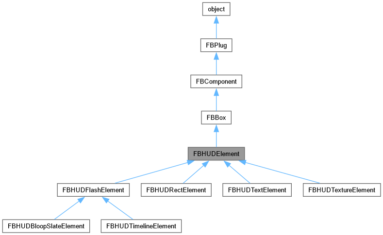

FBHUDElement Class Reference
Heads Up display. More...
#include <pyfbsdk_generated.h>
Inheritance diagram for FBHUDElement:

Detailed Description
Heads Up display.
Display scene related information on a camera output. Rendered on video out, output renderings.
