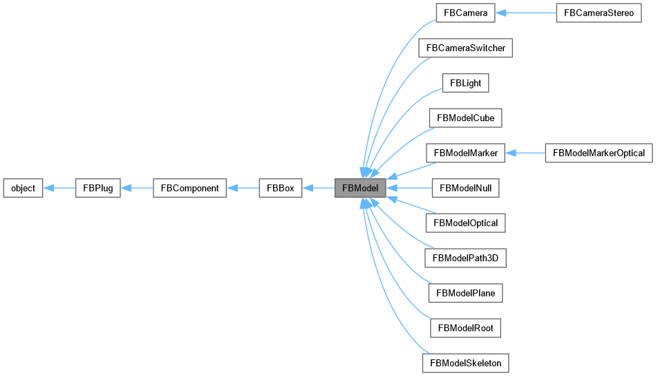

FBModel Class Reference
Model class. More...
#include <pyfbsdk_generated.h>
Inheritance diagram for FBModel:
