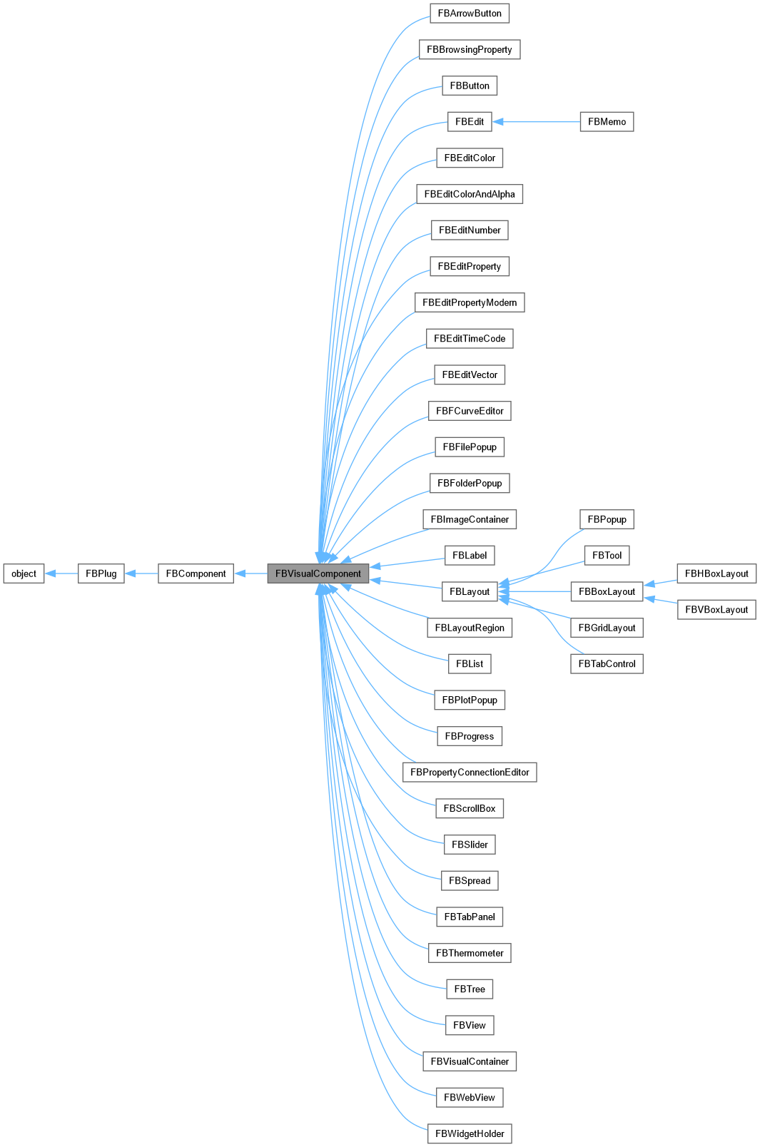

Visual Component base class. More...
All of the user interface elements available in the SDK derive from this class.
