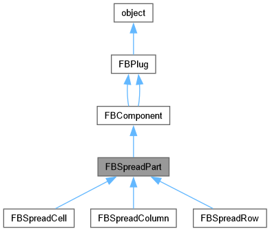

Spreadsheet part.
Due to protected constructor, this can only be created by a child object.
| int Column |
Read Only Property: Column number.
| bool Enabled |
Read Write Property: Is SpreadPart enabled?
| FBTextJustify Justify |
Read Write Property: Text justification for SpreadPart
| bool ReadOnly |
Read Write Property: Is SpreadPart read-only?
| int Row |
Read Only Property: Row number.
| FBCellStyle Style |
Read Write Property: Style of cell
