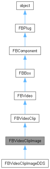

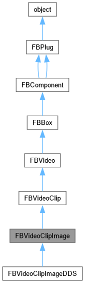

Video clip image media class.
Used for a variety of image types. For DDS images, use the FBVideoClipImageDDS instead.
| FBVideoClipImage | ( | str | pName | ) |
Constructor.
| pName | Name of image file. |
