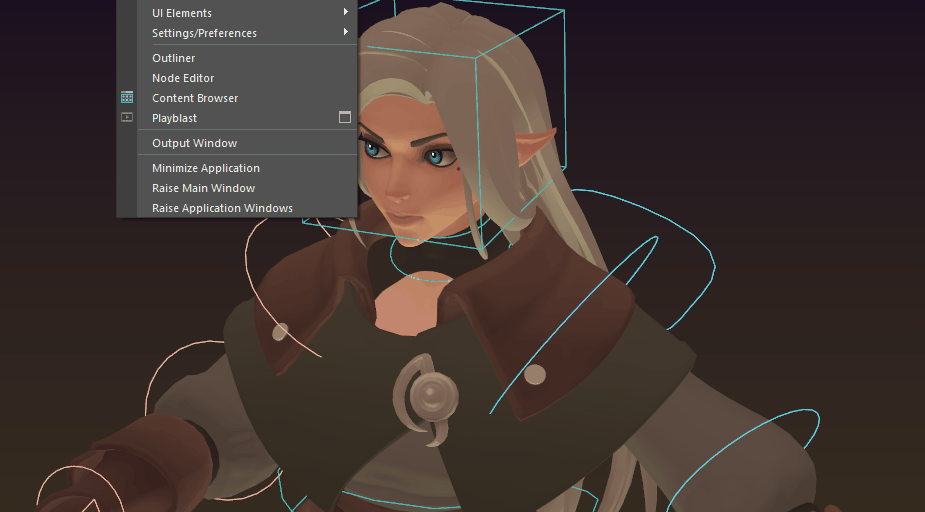

  2. Select Playback > Playblast > to open the Playblast Options.

To run Playblast when Maya is minimized on your screen
Important: If your animation speed is faster in your Playblast than the original scene, it may be because the animation speed in the Viewport is not playing at Frames Per Second (FPS). To resolve this, display Maya's Frame Rate by activating the Frame Rate is the Heads Up Display options. Play back your animation in the Viewport and check the frame rate. Most likely, it is not playing in real-time like the Playblast is. To change Maya's framerate, see the Framerate menu in the Playback Options.
For more information, see MEL Command reference.

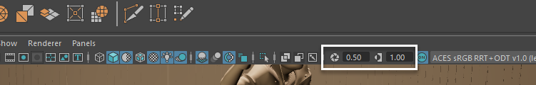

Setting Gamma and Exposure levels for a Playblast
Gamma and Exposure settings in the Panel Toolbar
The Gamma and Exposure settings in the Panel Toolbar affect your Playblast output. Exposure lets you adjust the brightness for the scene and Gamma adjusts the contrast.
