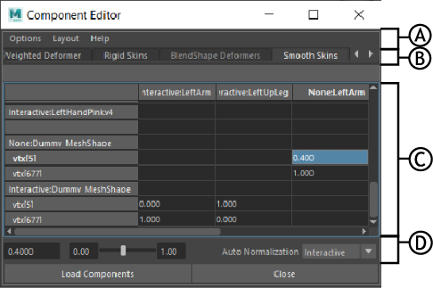

Component Editor menus and tabs
This topic covers the options and settings available in the Component Editor. When working with Skin Tools (skin layers), some options behave differently because weights are evaluated through the layer system. See Component Editor for information about using it to tweak the numeric values of individual components.
Note: The Component Editor supports multiple skin clusters, however the Total column only shows the amount of all weight on a vertex. For example, if there are two skin clusters, 2.0 is displayed in the Total column.

Component Editor tabs

Smooth Skins
Lists component data of CVs, vertices, or lattice points bound to a skeleton’s joints by smooth skinning (skin cluster weights).
Note: When skin layers are present, values in the Smooth Skins tab represent the evaluated result of the Skin Tools layer system. Edits are applied to the selected layer, and the final result is calculated from all layers. Some operations may be unavailable or may not produce expected results.

Component Editor spreadsheet area
  • Each component is a row, and each value or influence on the component is a column.
  • Click, shift-click, or drag across a cell, column, or row to select it.
  • Type a value to enter it in all selected cells.
Auto Normalization menu
The Auto Normalization menu shows the normalizeWeights attribute value of the skinCluster nodes shown in the editor. To set to value of the normalizeWeights attribute for all selected skinCluster nodes, choose a value from the drop-down menu. When using Skin Tools (skin layers), normalization is handled automatically and this menu is not available.
