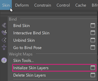

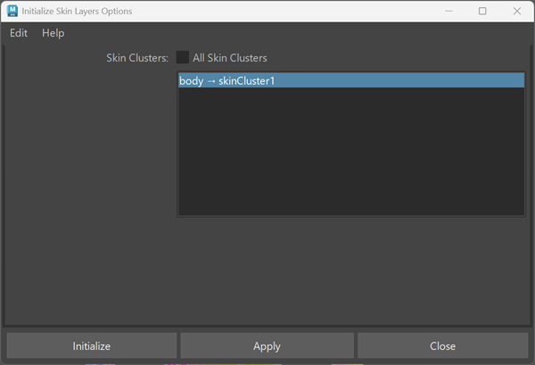

  • Choose Skin > Initialize Skin Layers
    In Initialize Skin Layers options, you can choose to initialize skin layers on all Skin Clusters or limit the operation to selected Skin Clusters.

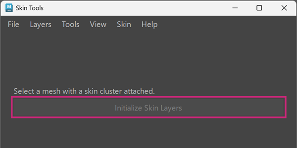

  • Open Skin > Skin Tools and click Initialize Skin Layers in the Skin Tools interface.

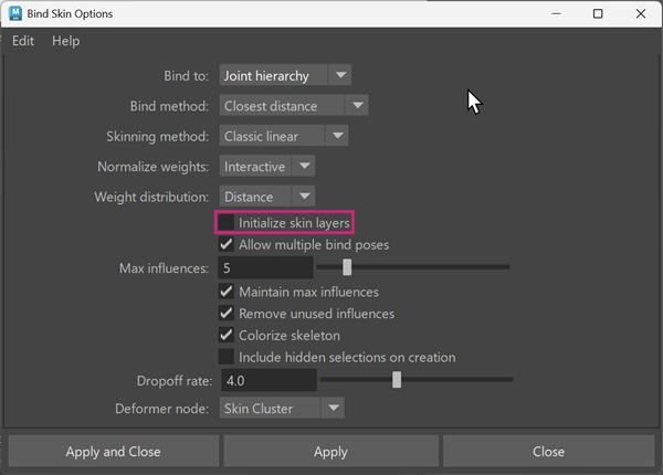

  • Enable Initialize Skin Layers in the Skin > Bind Skin options before binding.

  • Skin layers are created only when you explicitly initialize them on a Skin Cluster.
  • You must use Skin > Initialize Skin Layers, the Skin Tools window, or enable Initialize Skin Layers when binding.
  • Skin layers are not added automatically to existing Skin Clusters through other skinning operations.

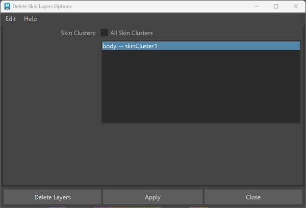

Delete Skin Layers
To remove skin layers from the selected Skin Cluster, use one of the following:
  • Choose Skin > Delete Skin Layers
    In Delete Skin Layers options, you can choose to delete skin layers on all Skin Clusters or limit the operation to selected Skin Clusters.
  • Open Skin > Skin Tools and delete the layers from the Skin Tools interface.
Deleting skin layers removes the layered structure and returns the Skin Cluster to standard Maya skinning behavior.
Note: Deleting skinning layers removes the layered data but does not change the resulting weights on the skinCluster. The current evaluated weights are preserved.
