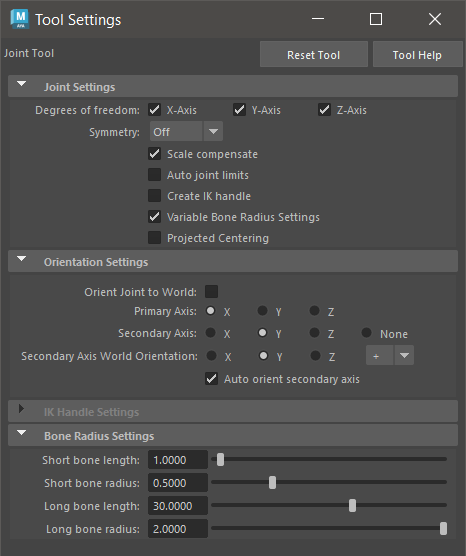

Joint Settings
Degrees of Freedom
Specifies which of the joint’s local axes the joint can rotate about during inverse kinematics posing. Click X, Y, or Z. The default setting allows the joint to rotate about all three of its local axes during IK posing.
Symmetry
Lets you enable or disable symmetry on joint creation. The following options let you specify which axis the symmetry connection has when it's created:
Off
By default, symmetry is disabled and the Joint Tool is in normal joint creation mode.
X-axis
Mirrors the joint across the X-axis.
Y-axis
Mirrors the joint across the Y-axis.
Z-axis
Mirrors the joint across the Z-axis.
Scale compensate
When this option is on, the joints you create are not scaled automatically when you scale joints above them in the skeleton’s hierarchy. Default is on.
Scale compensate can prevent undesirable shearing effects that can occur after you’ve skinned a character and then decide to scale a joint along one or two of its axes. Also, it can make it easier for you to change the length of individual bones.
Auto joint limits
When this option is on, Maya automatically limits the extent a joint can rotate about its axes according to the angles at which you build the skeleton’s joints. Also, the smaller inner angle of a joint rounded off to 180 degrees is set as the allowable range of rotation.
For example, when you create a knee joint, if you create the joint slightly bent back, the joint will not be able to swing the lower leg bone forward of the upper leg bone, nor will it be able to wobble from side to side. The joint will not be able to rotate in any other way except through the inner angle rounded off to 180 degrees.
Note:
  • Auto joint limits does not change the joint’s Degrees of Freedom setting. See Degrees of Freedom.
  • This setting does not apply to a joint chain’s start and end joints.
Create IK handle
When this option is on, an IK handle is automatically created for any joint chain you draw and the IK Handle Settings section of the Joint Tool settings is available.
The IK handle that is automatically created will run from the joint chain’s start joint to its end joint.
Note:
It is a more common practice to create a complete skeleton, and then add IK handles to the skeleton where needed.
Variable Bone Radius Settings
When this option is on, the Bone Radius Settings section of the Joint Tool settings is available. See the Bone Radius settings entry, below.
See also Set display size of all joints.
Projected Centering
When this option is on, Maya automatically snaps joints to the center of the selected mesh. See Snap to Projected Center.
Orientation Settings
Orient Joint to World
When on, all joints you create with the Joint Tool are set to align with the world frame. Each joint’s local axes have the orientation of the world axis, and the other Orient Joint settings are disabled. When off, you can specify the joint alignment using the other Orient Joint settings described below.
Secondary Axis
Lets you specify which local axis to use as the secondary orientation for the joint. Select one of the two remaining axes. To have Maya determine the Secondary Axis automatically, set to None.
Note: You cannot set the same axis for both the Primary and Secondary orientation. If you set either option to use an axis already specified, Maya automatically switches the other option to use a different axis.
Secondary Axis World Orientation
Lets you set the direction (positive or negative) in which the secondary axis points.
Auto orient secondary axis
Orients the secondary axis using neighbouring joints.
Activating Auto orient secondary axis also sets root joints to the plane defined by the child/grand-child joints and zeroes the joint orientation of terminal joints (that is, joints without children, so they match their parent's orientation).
IK Handle Settings
Specifies the creation options for the IK handle that is automatically created when Create Ik Handle is on. These options are available only when Create IK Handle is on. For more information on these options, see IK Handle Tool.

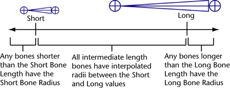

When you create joints, the radii of the joints are determined by the length of their bones. This means that when you draw a joint chain, the radius of all the joints in the chain automatically adjust to the length of their bones. For example, short bones like those in the human hand generate small joints and long bones like those in the human leg generate much larger joints than those in the hand.
Short bone length
Sets the bone length at which a bone is short.
Short bone radius
Sets the bone radius of short bones. This is the minimum bone radius.
Long bone length
Sets the bone length at which a bone is long.
Long bone radius
Sets the bone radius of long bones. This is the maximum bone radius.
