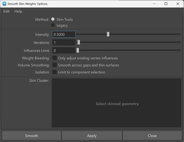

  2. Select Skin > Smooth Skin Weights > Options.
  3. Select a Method:
    • Select Skin Tools to use the default Skin Tools smoothing algorithm.
    • Select Legacy to use the legacy smoothing algorithm.
  4. If you selected Legacy, set Smooth Threshold as needed.

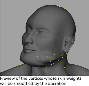

  5. To preview the affected vertices, turn on Preview and click Apply.

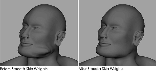

  6. Click Smooth.
When you use the Skin Tools method on a skinCluster without skinning layers, Maya creates a temporary layer for the smoothing operation and removes the layer when the operation is complete.
