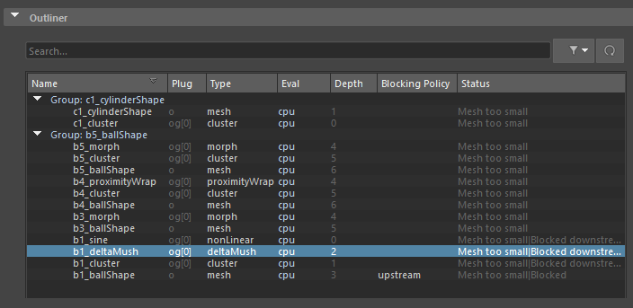

- Evaluation Graph Inspection
- This section provides a collection of tools that let you see how your evaluation graph and scheduling graph are constructed.
- Nodes to Inspect
- For each of the tools in the Evaluation Graph Inspection section you can choose to inspect either the entire graph, in which case you would choose
All from the drop down menu, or only a subset, when you would choose
Selected.
- When you choose
Selected another field labeled
Levels Deep appears. When displaying graph information you are usually interested in the connections between nodes. The
Levels Deep value tells the tool how many steps away from the selected nodes to include in the output.
- In this context, "steps away" means "number of connections it has to traverse in the graph to go from one node to another". For example, if you have the graph connections A -> B -> C then node B is depth one from both A and C, and C is depth 2 from A.
- For clarity, the functions below will be described as if you chose the
All option.

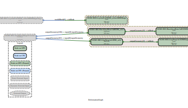

- Graphical Output
- Tools in this section will provide an output in either PDF or
DOT format for visualization of the evaluation or scheduling graphs. The visualization is similar to what you see in the node editor for the dependency graph.
| Format
| Select the type of output you wish to produce. If PDF is set, then the graph is sent to a
.pdf file. If DOT is set, then the graph is sent to a
.dot file. In both cases, the tool attempts to open the file in your default application for the generated file so you can see it immediately. For example Adobe Acrobat for a
.pdf file and graphviz for a
.dot file.
The
Transitive Reduction checkbox is an option that tries to reduce the number of unnecessary connections in the graph being displayed. The resulting output is cleaner though it can take significantly longer to generate.
| Output file
| This field shows where the file is created. By default, it is stored in your MAYA_LOCATION directory. Enter a new file name or browse to a new directory to change the location. The extension on the filename always reflects your currently selected
Format
(.pdf or
.dot).
| Visual Graph
| When you invoke the
Show button the visual representation of the Evaluation Graph will be generated in the format you have selected, and the result will open in your default application for that file type.
The
Add Dirty Plugs option includes a list of all plugs being set dirty in each node by the
Evaluation Manager. Normally, you would not want this amount of detail, but it's useful for discovering missing attribute dependencies in the graph
| Visualize Scheduling Graph
| When you invoke the
Show button, the visual representation of the Scheduling Graph is generated in the format you have selected, and the result will open in your default application for that file type.
The Scheduling Graph differs from the Evaluation Graph in that it groups sets of nodes together for evaluation as a group. For example, the invisibility evaluator clusters all of the invisible node together and evaluates them, by doing nothing, as one.
The
Add Cluster Contents option lets you switch the cluster nodes from displaying a count of the nodes they contain to a list of all nodes by name. This is useful when you want to see which nodes a particular custom evaluator has clustered together.

- Graphical Output
Expand the
Graphical Output section of the
GPU Override area to generate GPU deformer graphs that display information available with the
deformerEvaluator -c command as a connected graph using Graphviz.
- Format
- Select a format for the output file:
PDF,
SVG,
PNG, or
DOT.
- Output File
- Enter a name for the Output file. Click the folder icon
to browse to an output location.
- Include Plugs
Include plugs shows the full graph
- Disable this option if you do not want connections between nodes labelled with input and output plugs. This option is on by default.
- Selected Only
Selected only shows a condensed form of the graph
- Limits the graph to the selected nodes.
- Omit Passthroughs
Omit passthroughs shows and even more limited view of the graph
- Limits the graph to the selected nodes and leaves out any passthrough nodes.
- Visualize Deformation Graph
- Click the
Show button to create the graph.

- Outliner
The GPU
Outliner lets you keep track of nodes in the deformerEvaluator and the status of their blocking policies, if any.
GPU Outliner
- The GPU
Outliner has the following functionality:
- Shows which nodes are in the evaluator and how they are grouped.
- Shows which nodes evaluate on the GPU, cause a download to CPU, and which evaluate on the CPU.
- Has a filter so you can limit the view of nodes that, for example:
- Match a wildcard name
- Belong only to meshes
- Evaluate only on the GPU
- Filter for passthrough nodes
- Display both upload/download status
- Have a blocking policy set
- Use the name of the target mesh for the group
- Update when you open, create new, reference, or import a file.
- Right-click the
Outliner to open a contextual menu that lets you select nodes, visualize them as a graph, or set blocking policies.
