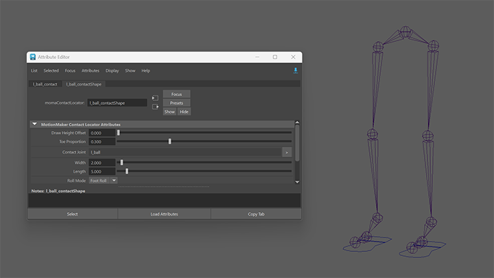

Create custom standard characters for MotionMaker
MotionMaker includes standard character definition tools for Bring Your Own Data workflows.
Use the Standard Character Definition section in the Attribute Editor to define across pair joints, gaiting joints, terminal joints, skip joints, and contact joints. Publishing the character definition creates the character definition and associated rig scene used by MotionMaker training workflows.
Contact joints can also be defined for use with Foot Slide Reduction.
