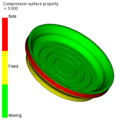

    The Compression surface property result shows which surface of the part has been assigned which compression surface property.
    • For the compression molding simulation, the surface of your model must have assigned the “compression surface” property type. There are three (3) compression element property types, depending upon where the surface resides in the mold.
      • The part surface nearest the fixed plate has the property of fixed surface.
      • The part surface nearest the polymer charge is the compression (moving) surface.
      • The elements on the side become the side surface.
        surface properties
  6. Review the Compression surface property result. Ensure that the Compression element (3D) property values are correct. These values were defined automatically by the program on the compression part mesh when the model was prepared for analysis. For this part the values are correct.
  7. Review the model using the Examine tool in the Results tab, the nodes will be shown with a numerical value.
    • 1 means the element is included in the compression surface, which moves during compression.
    • 2 means the element is included in a fixed surface, which does not move during compression.
    • 3 means the element is on a side surface, which can move in the compression direction but does not move in the direction normal to the side surface.
