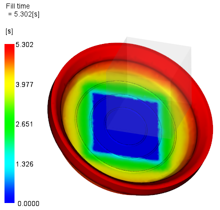

This tutorial familiarizes you with the setup of the compression molding process and review of key results.
Tutorial duration: Approximately 45 minutes.
Autodesk Moldflow Insight is set for simulating injection molding of thermoplastics parts, by default. Most of the tasks required to simulate other processes are the same. However, the procedure to setup a compression molding process requires a few extra steps compared with the setup of an injection molded part.

coaster fill time
