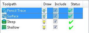

  1. Initially the tool has four toolpaths associated with it:
  2. Select two of the toolpaths:
  3. Click . This leaves two toolpaths associated with the original tool:
    and two toolpaths associated with the new tool:

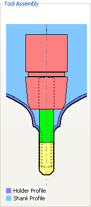

Holder Clearance — Specify the minimum allowable distance between the model and the tool holder profile.
Shank Clearance — Specify the minimum allowable distance between the model and the tool shank profile.

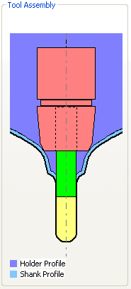

The Holder Profile tab displays the Holder Profile and the Shank Profile.
If you just want to see the Holder Profile select the Holder tab.
Note: If the Holder Clearance and Shank Clearance are different, you see two profiles.

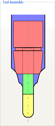

Tolerance —Specify how accurately the tool holder profile follows the model.
Maximum Profile Diameter — Specify the maximum diameter of the profile (either the holder or the shank). The value 0.0 means no maximum diameter is set.

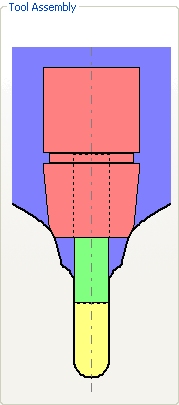

Maximum Profile Diameter —0.0 (unlimited):

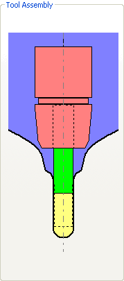

Maximum Profile Diameter — 90:
