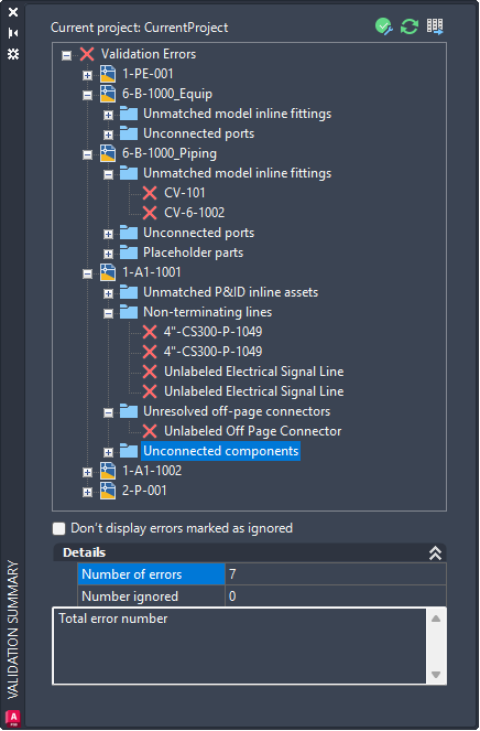

About Validation Report
The validation report provides a summary of issues identified in drawings and models. After reviewing and correcting the issues, the project can be revalidated to confirm that the problems have been resolved.

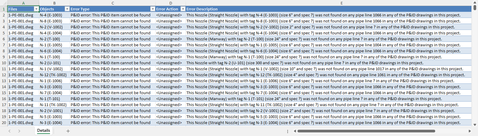

Validation reports can be exported to improve readability and facilitate data review. In the Validation Summary window, click Export, then select the desired file format. Supported formats include Microsoft Excel Workbook (XLSX) and CSV.
Note: The XLSX report is formatted as a table, enabling easy filtering and sorting of the data.
