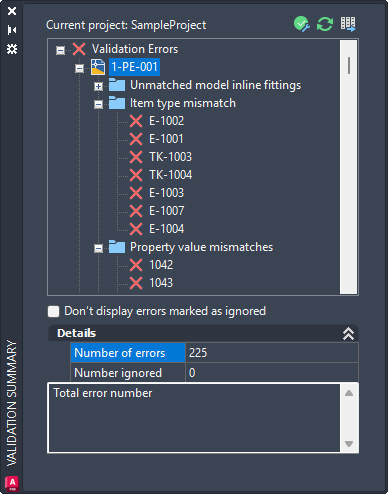

Validation Summary Window
Displays drawing validation errors, which you can correct or ignore.
 Shortcut menu: Project Manager Right-click the project node Validation Summary
 Ribbon: Home Validate tab Validate Summary (in P&ID workspace)
 Command entry: validatesummary
Current Project
Displays the name of the current project.
Configure Validation Settings
Displays the P&ID Validation Settings dialog box.
Revalidate Selected Nodes
Validates the selected nodes again.
Export
Exports the validation report to a file with the XLSX or CSV format.
Validation Errors List
Displays the errors found in each drawing in the current project.
Don’t Display Errors Marked as Ignored
Suppresses the display of errors that are marked as ignored. This option is turned off by default.
Details
Displays information about the selected error.
  • Error Type. Displays the type of error that is flagged.
  • Object Type. (Base AutoCAD Objects errors only) Identifies the AutoCAD object type.
  • Component Size. (Size mismatch errors only) Displays the component size.
  • Line Size. (Size mismatch errors only) Displays the line size.
  • Component Spec. (Spec mismatch errors only) Displays the component spec.
  • Line Spec. (Spec mismatch errors only) Displays the line spec.
  • Error Action. Specifies how the error is addressed. By default, this option is listed as Unassigned. For all error types, you can change the status to Ignore. For base AutoCAD objects, you can erase the object. Alternatively, you can correct all errors manually.
Error Description
Displays a description of the error type that is selected in the validation errors list.
