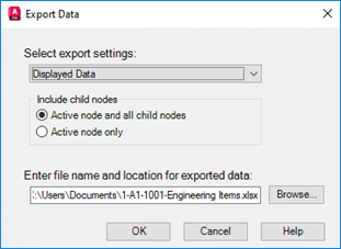

In the Data Manager, in the drop-down list, click the appropriate data view.
In the tree view, click the node to export.
Click Export.
In the Export Data dialog box, in the Select Export Settings list, click Displayed Data or a custom setting.
Note:
Only Displayed Data is available for area or customized views.
Under Include Child Nodes, click the appropriate option to include the active node and all child nodes, or the active node only.
Under Enter File Name and Location for Exported Data, do one of the following:
To use the default file path and file name, click OK and go to step 9.
To select a different file path or file name, click Browse.
In the Export To dialog box, do the following:
Navigate to and select a folder to store the exported files.
In the File Name box, enter a file name or use the default file name provided.
In the Files of Type box, select the file format for the exported files: XLSX (the default) or CSV.
Click Save.
In the Export Data dialog box, click OK.
