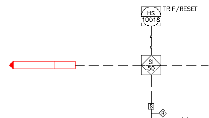

Base AutoCAD Object
Example:
Description: An AutoCAD object or block (instead of an AutoCAD P&ID component) has been inserted in the drawing. Such blocks do not show up in reports or in the Data Manager, even though they may look like a P&ID component.
To Correct:
  • Erase the object.
  • Ignore the error.

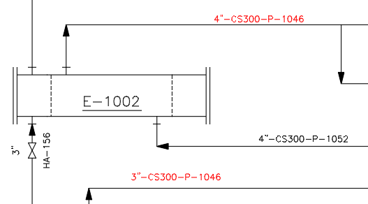

Size Mismatch
Example:
Description: The size of a line and its associated component do not match. This condition is usually caused by manual changes to the component properties.
To Correct:
  • Manually fix Size Mismatch errors. You must change the size of either the line or its associated component at the connection point so that they match.
  • Ignore the error.
