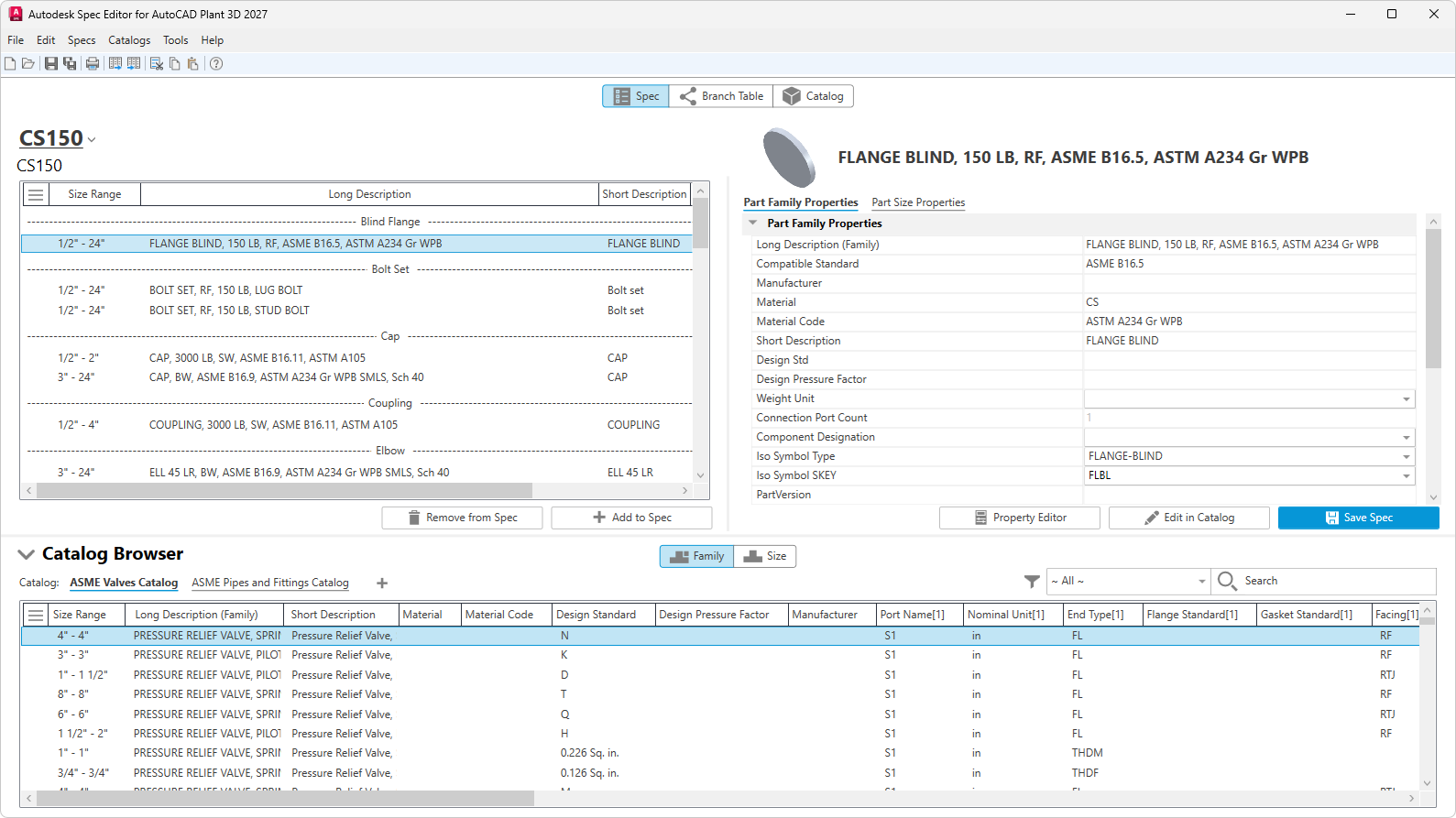

The following improvements have been made to the Spec Editor in this release:
- Multiple selected cells can now be copied using Ctrl+C and pasted using the shortcut menu in the Property Editor dialog box.
- The Enter key now supports navigation in the Manage Size tab of the Property Editor dialog box.
- Changes made on the Part List tab can now be undone in the Property Editor dialog box.
- One or more sizes can now be removed from the Part Size Properties list using the shortcut menu on the Spec tab.
- Size management for block-based components is now supported in the Spec Property Editor.
- The scale in the Branch Table can now be adjusted from 10% to 400% using the scaling bar. Clicking the + or - button adjusts the scale in 10% increments.
- Filters have been added to the shortcut menu in the Catalog Browser.
- Searches in the Size column of the Catalog Browser now provide more accurate matching.
