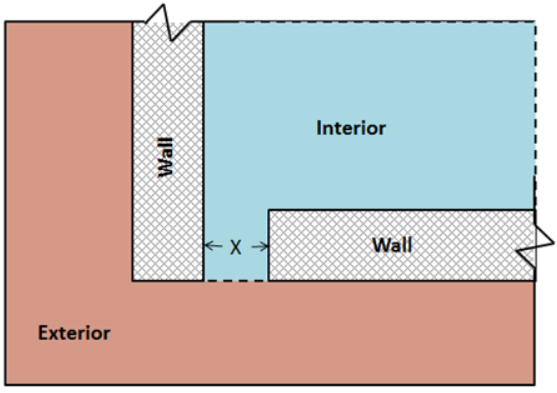

The maximum distance between Revit elements that may be ignored in the identification of energy model spaces is 2 times the Analytical Space Resolution setting.
This concept can be illustrated as follows, where the plan view shows 2 walls bounding an interior space with a gap between them of dimension X.
If Analytical Space Resolution = 18 inches (457.2 mm), then:
