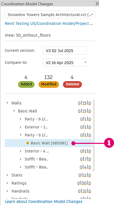

Click Collaborate Coordinate tab Coordination Model Changes button to open the Coordination Model Changes palette.
Models & Versions: From the drop-down list, select a model for changes comparison. The default state runs the changes analysis calculation for the latest two consecutive versions. If you want to compare the current version to a different version, choose it from the "Compare to" drop-down list.
The path displayed below the model selected in the top dropdown shows the model location in the cloud.
The palette displays an overview of changes, classified in 3 categories: added, modified and deleted objects. An example is shown below:
Changes summary: The palette displays an overview of changes, classified in 3 categories: added, modified and deleted objects. For a quick identification, the added, modified and deleted coordination model objects are highlighted in Revit views. The unchanged coordination objects are greyed out.
By default all types of changed elements are toggled on. To toggle off Added, Modified, or Deleted, click them. For example, if you want to visualize the Added objects only, click Modified and Deleted. Consequently, the modified and deleted objects will no longer be highlighted on the model.
Changed elements list: The changed objects are displayed in a list, in a hierarchy of objects categorized on element types. Each category and subcategory contain information about the numbers of added, modified, and deleted objects, detailed in a label. You can explore the list of changed objects by expanding or collapsing the categories and subcategories of the hierarchy of objects.
The colors of the changed objects are preselected in Revit views, elevations, section, etc. once a category, subcategory or a coordination model object is selected in the hierarchy of objects. The preselected color can be changed from the Revit option Colors tab Pre-selection field.
To close the Coordination Model Changes Palette, click the Coordination Model Changes button, and the coordination model gets back to the initial visualization.
