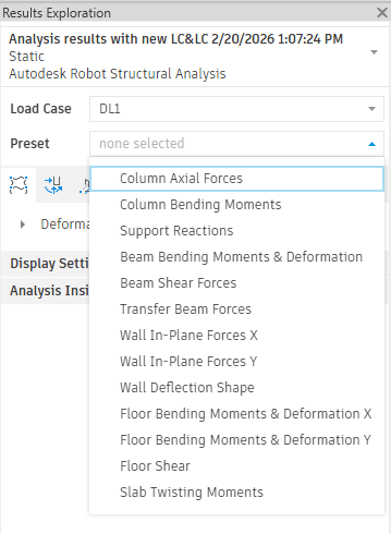

Result Presets
To simplify results exploration, instead of manually searching for and selecting the results types you want to explore, 13 predefined presets are available.

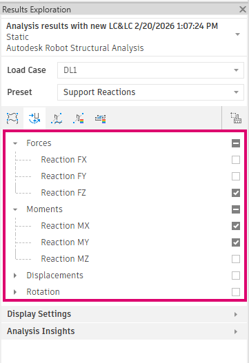

Select one preset to automatically populate the results types and the corresponding elements.
