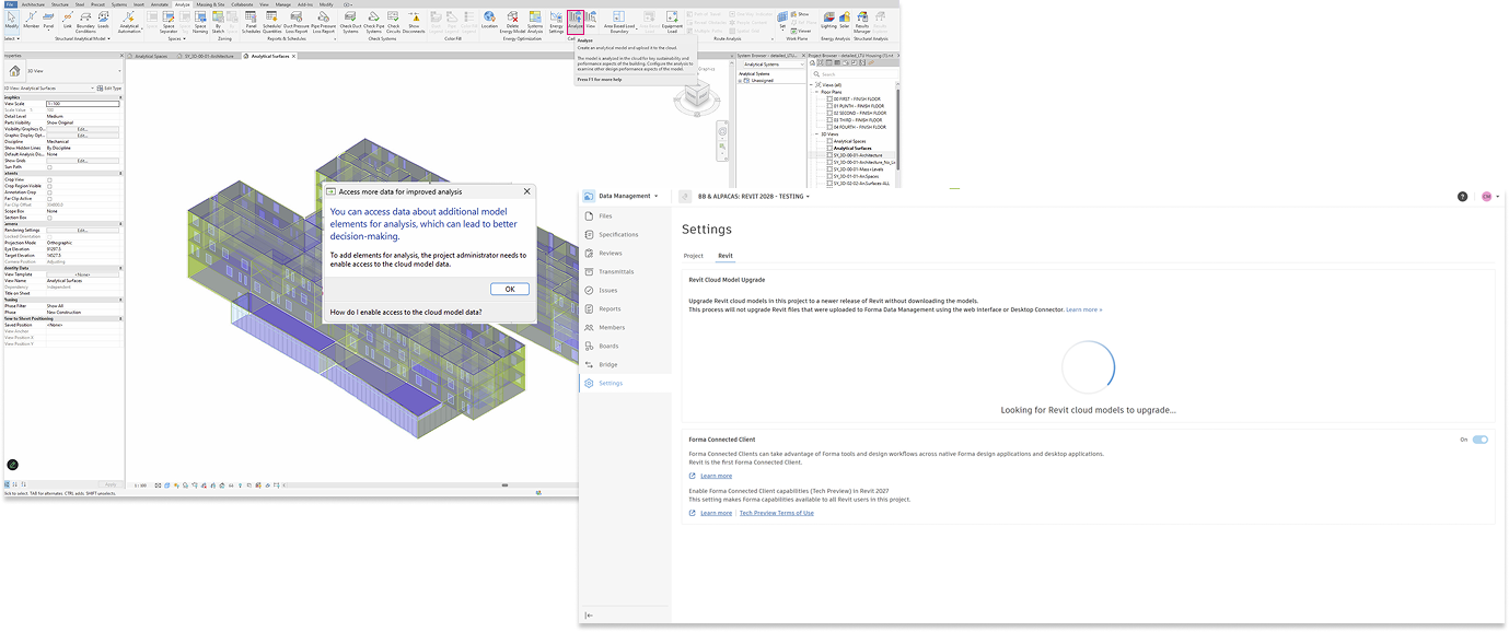

Expanded Embodied Carbon Scope (Tech Preview)
The Embodied Carbon analysis scope has been expanded to include additional Revit elements, including structural elements, when working with cloud models.
You can:
  • Submit analyses to Forma Carbon Insights
  • Include additional structural element data
  • Ensure latest model data is used for analysis
This enhancement provides a more complete sustainability assessment.
The model can be workshared or non-workshared.
Turn on the Forma Connected Client under Forma Data Management Settings Revit.
Note: This is a Tech Preview and may include limitations or partial element coverage.
See Building Model Embodied Carbon Details.
