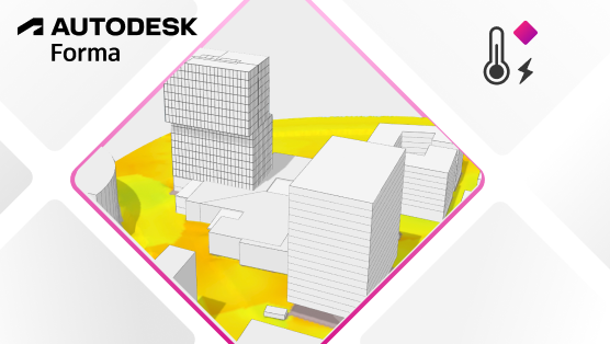

As a Forma Connected Client, Revit supports microclimate analysis to evaluate perceived temperature on site, combining sun hours, daylight potential, and wind exposure with localized weather and climate data.
For a model that is set up for use with Forma tools, open a view that contains terrain and contextual data, such as building models, surrounding buildings, and other context. Then click Analyze tab > Forma Analyses panel > (Microclimate) to run the analysis. Results typically display in 4-10 seconds.
