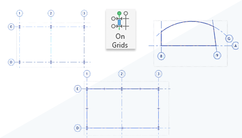

On Grids option allows creating analytical elements using grids, just like physical elements.
Analytical Elements at Grids
Creating analytical elements—members and panels—is now much easier with the On Grids option. You can create vertical analytical members at the intersections of the selected grid lines or on selected grid lines between existing vertical analytical members at grid intersections. You can also create analytical panels by extruding along selected grid lines between intersection points.
See Place Analytical Members and Analytical Panels.
