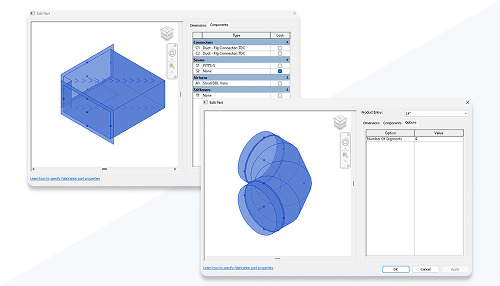

Part editing and documentation for MEP fabrication parts has been improved.
You can edit seams, airturns, and stiffeners for fabrication parts in the Edit Part dialog. You can also edit the number of segments for segmented elbows.
