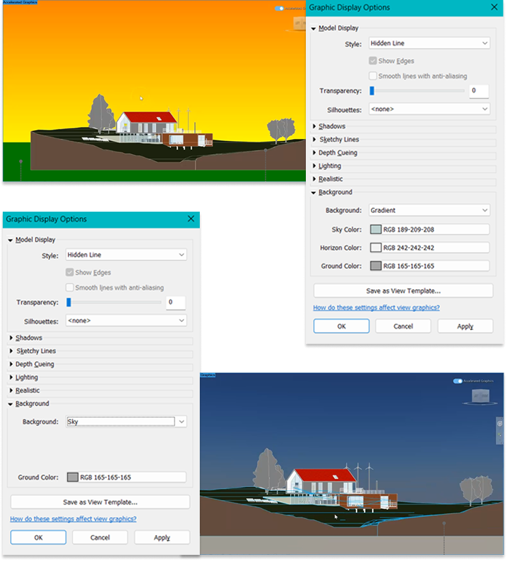

Gradient and sky backgrounds in accelerated views display in parity with original Revit graphics.
- For gradient background, the display is based on sky, horizon, and ground color.
- For sky background, the display is based on round color and sun settings.
