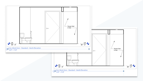

View Titles: Enhanced Snapping
Place and align view titles faster and more precisely.
You can snap view title extension lines and entire titles directly to key geometry—including view boundaries, crop regions, sheet elements, title blocks, and guide grids—without needing to preselect the viewport. Extension line grips are now available right when selecting the view title, streamlining layout adjustments and improving accuracy.
This feature is described on the product road map.
This feature was suggested by customers on the Ideas forum.
See Modify a View Title on a Sheet.
