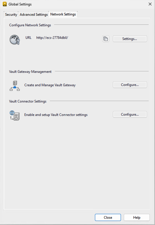

Access the Network Settings Tab on the Global Settings Dialog Box
View your network configuration and configure SSL for secure communication on the Network Settings tab of the Global Settings dialog box.
  1. In the ADMS console, select Tools > Administration.
  2. In the Global Settings dialog box, select the Network Settings tab.
  3. The Network Settings tab displays a server URL used for connecting to the Vault Client.
    The URL includes the following:
    • Protocol (http/https)
    • Host Name
    • Port number - Not visible in the URL if the default port is configured. If the configured port is different from the default port (80), the port number follows the hostname, separated by a colon. For instance, :81).
  4. Click the Copy button to copy the URL to your clipboard.
  5. An error message is displayed if the local system is unable to establish a connection. Double click on the error message to copy the message to your clipboard.
  6. Click Settings to configure or modify the network configuration.

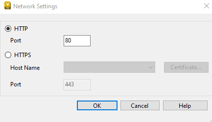

Configure Network Settings
In the Network Settings dialog, configure the network settings to access the Vault server.
Access Vault Server over HTTP
  1. Select HTTP to access the vault server over http.
  2. Edit the Port number if you want to set a different port for connection. The default port is 80.
Access Vault Server over HTTPS
  1. Select HTTPS to access the vault server over https.
  2. Click Certificate to configure SSL with a new certificate.
    1. In the Select a Certificate dialog, select the SSL certificate from a list of trusted certificates.
      Note: Select only one certificate to enable SSL connection. Multiple certificate selection is not allowed.
    2. Click View Certificate to view the certificate details.
  3. Select the Host name.
  4. Edit the Port number if you want to set a different SSL port for connection. The default port is 443.
  5. (Optional) In the Client ID field, enter the Client ID from your registered APS application to enable Autodesk ID sign-in for the Vault Thin Client. See Configure Autodesk ID Sign-In for the Vault Thin Client.
  6. Click OK.

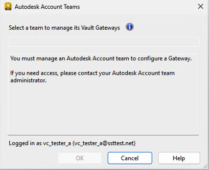

Vault Gateway Management
View, configure and manage gateways for Vault.
See Vault Gateway for more information.

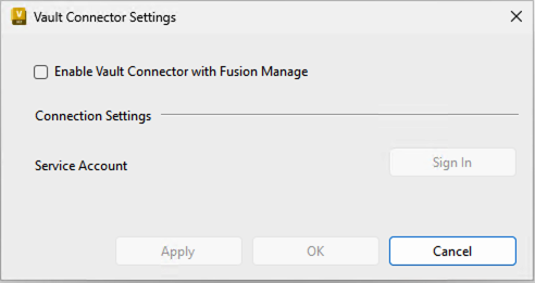

Vault Connector Settings
Enable and configure the Vault Connector service.
See Configure Vault Connector for more information.
