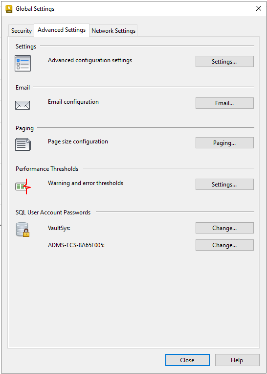

Advanced Vault Server Settings
Fine tune your Vault Server performance and configure additional server settings, such as e-mail notifications and number of rows displayed on a page, on the Administration tab of the Global Settings dialog in the Autodesk Data Management Server Console.
Access Advanced Settings for the Vault Server
- In the ADMS Console, select Tools > Administration.
- In the Global Settings dialog box, select the Advanced Settings tab.
Features Summary
Feature | Description |
Advanced configuration settings | Configure the following advanced settings: - Impersonation credentials
- Connection timeout threshold
- New share path
- How many log files are displayed
- Number of days that you want the server to retain a history of server tasks.
Email configuration | Identify email recipients and send test email messages. |
Page size configuration | Configure how rows of data are displayed on a page. |
Warning and error thresholds | Configure performance thresholds. |
SQL User Account Passwords | Change the password for the VaultSys and ADMS_%SiteName% SQL Service Accounts. |
Manage Server License | View and change the Vault Server license. |
