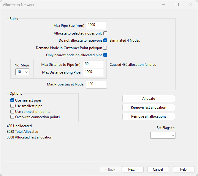

Finally, InfoWorks attempts to allocate demand to nodes so that all the rules remain satisfied. By default, InfoWorks uses the To node for allocation if the nodes at both ends of the pipe are valid. You can check the Demand At From Node box for any customer point where you want to change this behaviour. The node to which demand is allocated is the Demand Node.

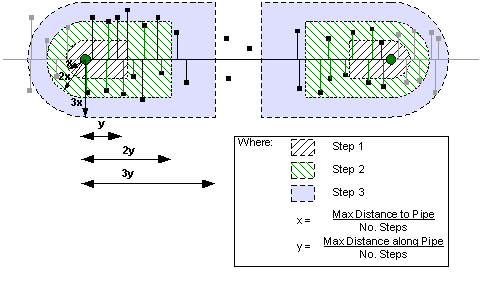

In order to carry out an accurate demand allocation, an iterative process should be used, increasing the maximum distance along a pipe and the maximum distance to the pipe after each allocation.
The example below shows a demand allocation carried out in five distance steps, increasing the distance along the pipe and distance to the pipe by 100 each step.

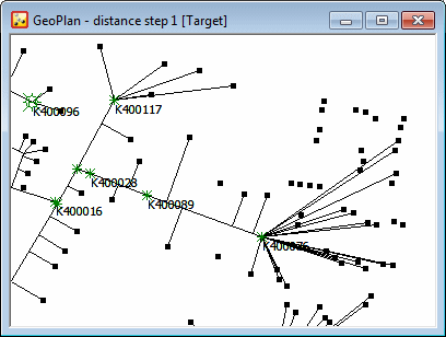

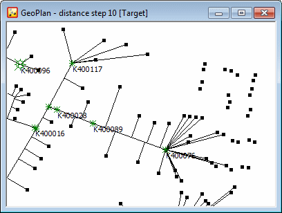

For example, if the customer points that could potentially be allocated to a node exceed the Maximum Properties at Node specified by the user in the Demand Allocation Wizard, allocation of these customer points to the node is effectively random. Customer points further from the pipe may be allocated, while customer points closer to the pipe may not. This is demonstrated in the example below, where demand allocation has been carried out on the same network, using the same allocation parameters, but with a different number of distance steps.
Demand Allocation carried out using one distance step
Demand Allocation carried out using ten distance steps

The Max Distance to Pipe and Max Distance along Pipe rules, specified by the user, represent the limits to be used at the last distance step. These limits are divided by the number of distance steps to calculate the amount to increment the Max Distance to Pipe and Max Distance along Pipe parameters at each allocation step.

Allocate
Attempts to allocate the demand using the above Rules and Options. When the allocation is complete, the Rules box will contain additional information about how the rules that have been applied have affected the allocation process.
