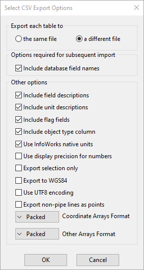

Select CSV Export Options dialog
This dialog allows you to select the options when exporting data to CSV files.
The dialog is opened, for example, by right-clicking a network in the Model Group window and selecting Export To CSV.
Not every option is available on all instances of the dialog.
Item Description
Output File
Clicking the ellipsis button displays a standard File Open dialog, which allows you to select the location where the output file will be saved.
Note: This option is only available when the dialog is accessed by clicking the Export Network/Control from CSV task in the Task Sequence editor.
Export each table to
the same file Exports all tables to the same file.
The same data is exported whether you choose to export to one file or a file per object type. Your choice depends on what the exported data will be used for.
a different file Exports each table to a separate file.
Options required for subsequent import
Include database field names
Field names provide column headers when viewing the data. Required for subsequent import into InfoWorks WS Pro
Include field descriptions
Additional information useful when viewing the data outside InfoWorks WS Pro.
Include unit descriptions
Include flag fields
Will increase the size of your CSV files. Only check this box if you need the flag data.
Include object type column
Additional field containing database Table Name information.
Use InfoWorks native units
We recommend that you check this if you intend to re-use the data in InfoWorks WS Pro. Any changes made by a user to the units used in the InfoWorks WS Pro interface (User Units) are only stored locally for that user.
Use display precision for numbers
Storage precision for some numbers is greater than display precision. For example, numbers stored as doubles have 15 decimal places. No numbers are displayed at this precision. Leaving this option unchecked may increase the size of your files
Export selection only
For this option you need to have the network open, and one or more network objects selected. Only the selected objects will be exported.
Export to WGS84 If checked, coordinates will be exported using the WGS 84 geodetic system. This is for use in systems that require the WGS 84 geodetic system.
Use UTF8 encoding Select this option to encode the exported data using the UTF-8 encoding system.
Export non-pipe lines as points
If checked, objects that are represented as lines will be represented as points in the export data. This is so that they can be used in models that require all assets to be represented as points.
The objects that are converted from lines to points are pump stations, valves, float valves, non return valves, and meters.
Coordinate Arrays Format
Including this data may greatly increase the size of your CSV files, so think carefully whether you need this data. If you want to re-create the network elsewhere, or re-import, failing to export arrays will cause loss of data.
There are three options for export of coordinate data:
  • None Coordinate arrays will not be exported
  • Packed Coordinate arrays are exported in the format {x1, y1, z1, x2, y2, z2 ... xn, yn, zn} for example
  • Unpacked Coordinate arrays are exported to separate fields with headers xs, ys (and zs if there are z coordinates)
Other Arrays Format
There are three options for export of array data other than coordinate data:
  • None Other arrays will not be exported
  • Packed Each array is exported to a single field
  • Separately Arrays are exported to a separate block or a separate file depending on the choice of the Export each table to option. Each value in the array is exported to a separate field.
