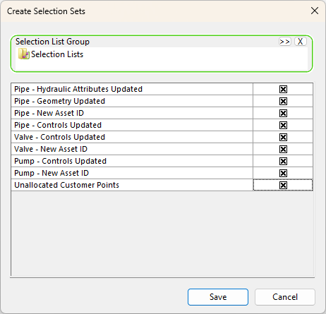

Create Selection Sets dialog
When changes have been made to the network/control, this option will create selection lists with things that have changed.
Checking the box will enable a particular selection list, which will be created when you run the task in the Task Sequence.
If you have an automatic model build, this will allow you to manually check the changes that the model builder has made.
This dialog is displayed when you click the Validation Selection Set task in the Task Sequence editor.
Item Description
Selection List Group Use drag and drop or the Browse button to add a Selection List object in the dialog.
Pipe - Hydraulic Attributes Updated
Pipe - Geometry Updated
Pipe - New Asset ID
Pipe - Controls Updated
Valve - Controls Updated
Valve - New Asset ID
Pump - Controls Updated
Pump - New Asset ID
Unallocated Customer Points
Select the item by checking the box.
