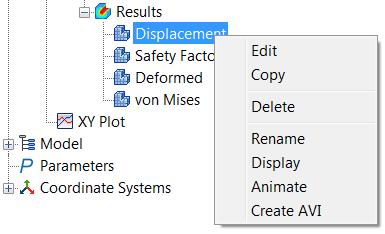

Displaying Results
The easiest way to display the most common results quantities is through the Results branch of the Analysis tree. The most commonly used results quantities are automatically added to the branch for you:
  • Displacement: A scalar value showing how much the model changes in response to applied loading.
  • Safety Factor: A scalar quantity that shows how much stronger a structure is beyond its applied loading.
  • Deformed: Shows how the model changes shape in response to applied loading. Note that the deformed shape of the model is displayed, but no scalar results are shown. See the Deformation section below for additional information.
  • von Mises: This is the solid stress, and is best for predicting yield in ductile materials.
To display a quantity, modify how the quantity is displayed, or to animate the deformation, right-click on the branch for a specific result quantity and choose from the available options:

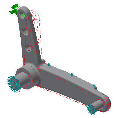

Deformation
The primary use of the deformation plot is to show how the part or assembly changes shape in response to applied loading. To show deformation, in the Results branch of the tree, right-click Deformed > Display.
To control the deformation plot, in the Results branch right-click Deformed > Edit and in the Plot dialog, click the Deform Options tab. Be sure the Vector is set to Displacement and the Type to Total:

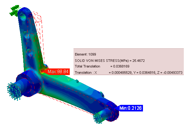

Probe
To view the exact value of a quantity on the model, click Probes from the Results panel of the ribbon. While the Probe tool is active, an information box displays the active scalar value where the cursor contacts the model:
