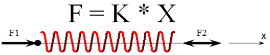

Basic FEA Concepts
Force is determined from measured displacements:
Stress is determined from measured displacements:
Note: If the deformed response is incorrect, stress response will be incorrect as well.

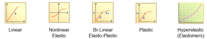

Material Properties
It is critical to use the appropriate material type. For linear analyses, the choices include:
  • Isotropic
  • Orthotropic
  • Anisotropic
In some cases, you may need to use nonlinear materials instead. You should consider if it is feasible to idealize a nonlinear material as linear. Determine if you are in the linear elastic range or if you should be:

FEA basically solves F= Kx {F}=[K]{x} or P= Ma+Bv+Kx for dynamics.
Zero values in stiffness and mass will result in singularities, resulting in a solution that fails.
