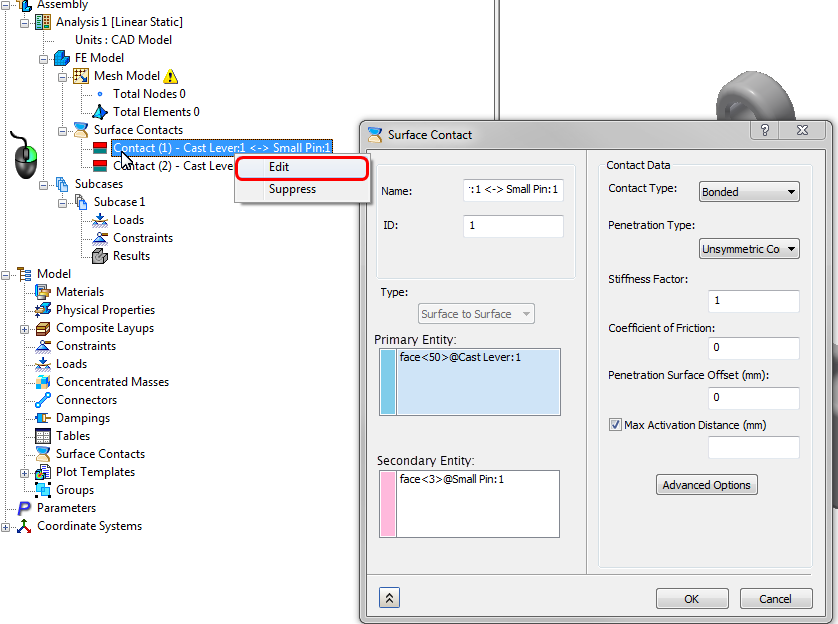

To run an Automatic contact calculation, click Automatic from the Contacts panel in the ribbon:
This causes Inventor Nastran to identify contact pairings throughout the model and assign a contact condition to each.
By default, all automatically-computed contact pairs are set to Bonded. This means that the two parts move together at the contacting surface due to forces acting on the model. To change the contact definition, right-click on the contact entry in the Tree, and click Edit. You can then select the desired contact type from the list:

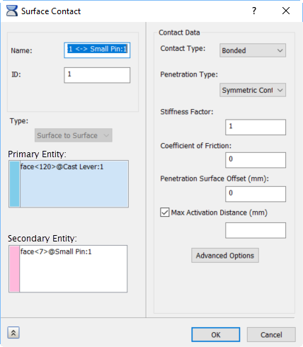

Assigning contacts manually allows for greater control over the contacting surface pairs. To do this, click Manual from the Contacts panel in the ribbon:
On the Surface Contact dialog, there are two options for defining contacts:
Auto
The Auto option allows you to define multiple contacts automatically. You only need to define a single contact boundary for each contact pair.
Notes:
  • The Tolerance and Max Activation Distance define the separation between two surfaces considered to possibly be in contact. The value is roughly the physical separation distance between the two entities.
  • The Stiffness Factor is the stiffness of the contact joint. This value is based on the stiffer of the two joined sections. Use the default value if the two entities have similar stiffness values.

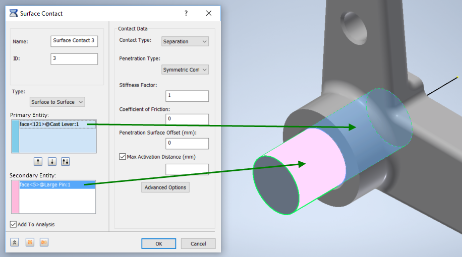

Manual
With the Manual option, you specify the primary and secondary surfaces or edges involved in the contact.
The primary surface usually has the more coarse mesh. The secondary surface cannot penetrate the primary. The use of a symmetric Penetration Type eliminates the distinction.
Notes:
  • The Max Activation Distance should be slightly larger than the maximum expected sliding or motion.
  • For similar surfaces, the default Stiffness Factor is acceptable. Reduce the value if one body is much softer than the other. Increase the value if the contacting entities penetrate one another too much.

  1. In general, when selecting the Manual option to setup contact, choose the primary as the contact segment that has the least amount of curvature, or if it is cylindrical contact choose the primary as the outside segment (and use unsymmetrical penetration).
