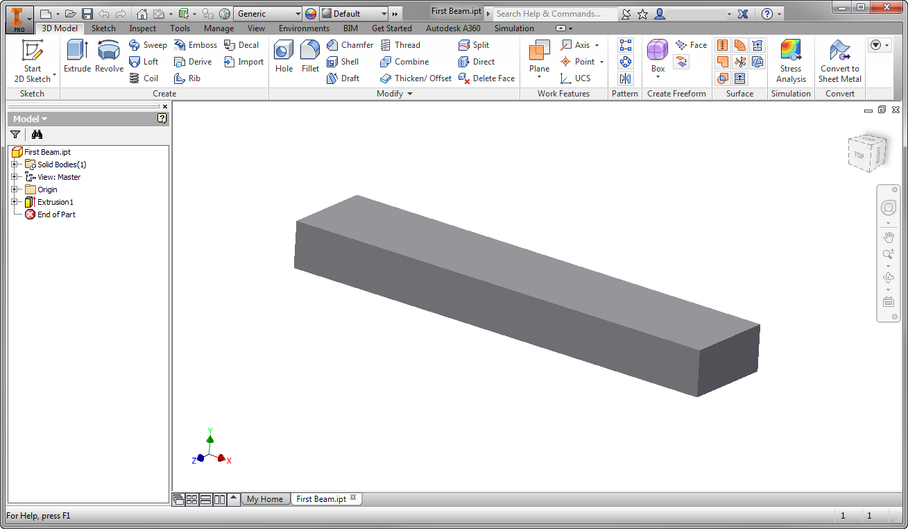

1. Open the Model
Start Autodesk Inventor, and open First Beam.ipt from the Section 3 - Cantilevered Beam sub-folder of your training exercises folder. You should see this, although the Model pane on the left might not be visible:

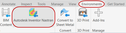

2. Start the Autodesk Inventor Nastran Environment
  1. From the ribbon, click the Environments tab.
  2. Click Autodesk Inventor Nastran.

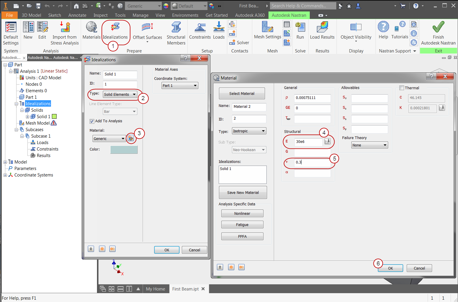

3. Assign the Physical Property
  1. Click Idealizations from the ribbon.
  2. On the Idealizations dialog, confirm the Type is Solid Elements.
  3. Click the New Material icon.
  4. On the Material dialog, enter 30e6 for E (Young's Modulus).
  5. Enter 0.3 for v (Poisson Ratio).
  6. Click OK on the Material dialog.
  7. Click OK on the Idealizations dialog.

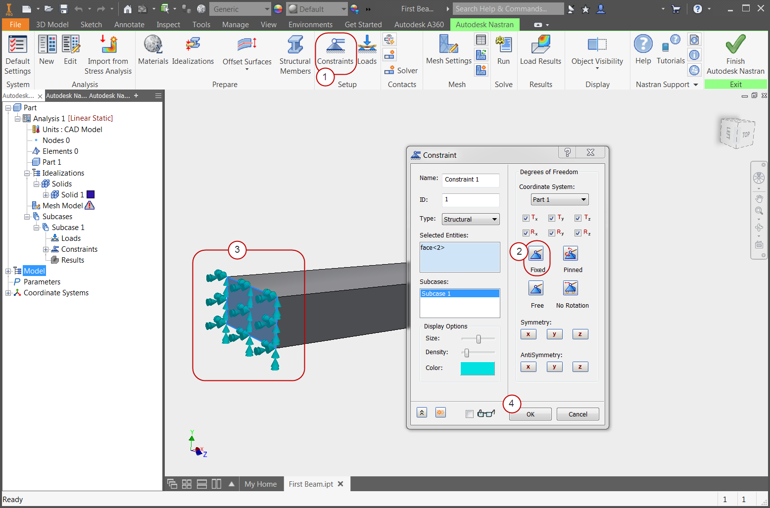

4. Constrain the Beam
In this step, we assign the condition that fixes the beam on one end, preventing movement in any direction.
  1. Click Constraints from the ribbon. Click and move the View Cube in the upper right of the Inventor window to reposition the beam so you have a clear view of one end.
  2. On the Constraint dialog, click Fixed. (This is the default setting.) Under Display Options, you can also use the Density setting to control the number of constraint symbols that will appear in the image.
  3. Click the end of the beam, as shown in the image.
  4. Click OK.

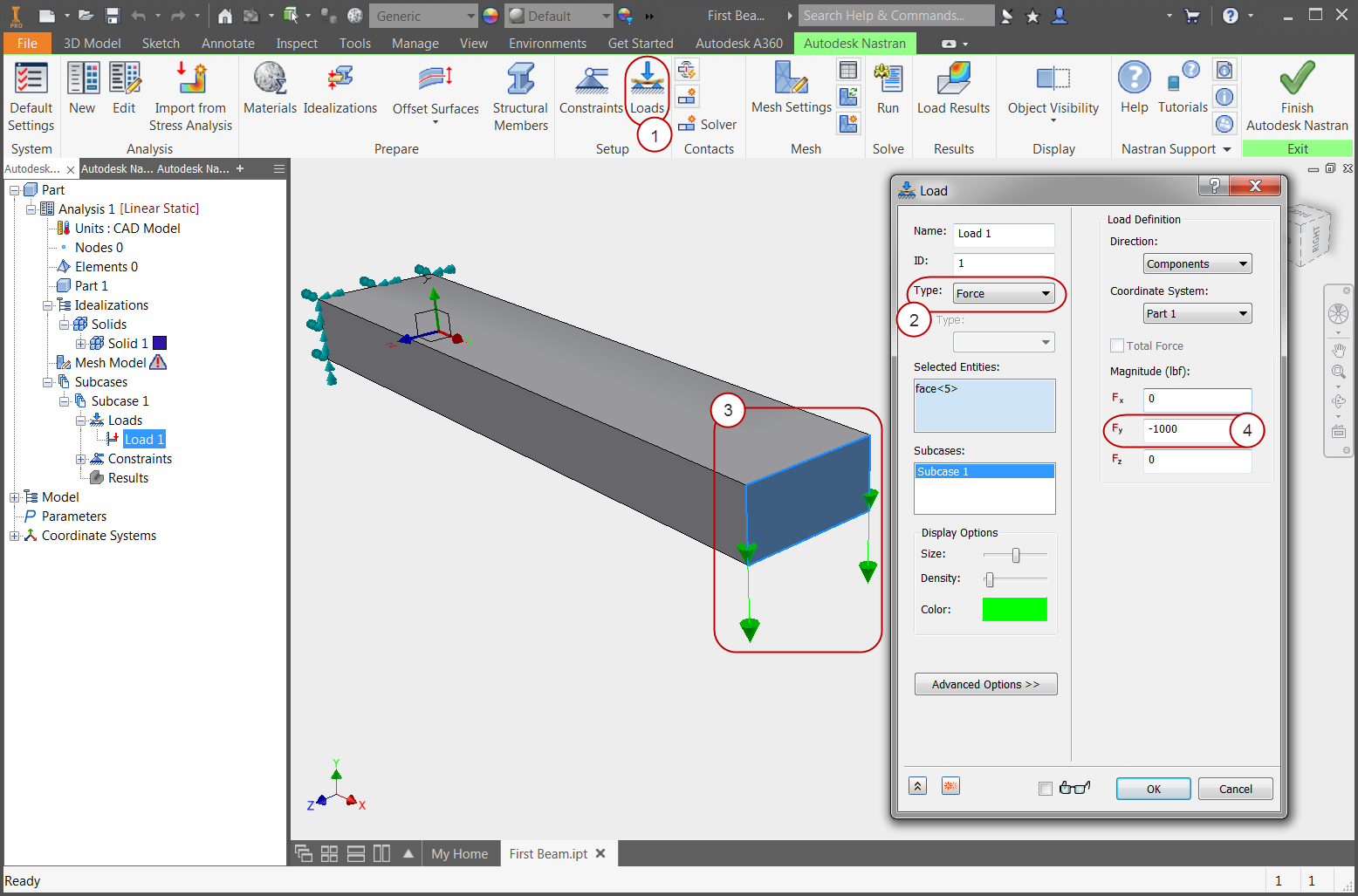

5. Load the Beam
  1. Click Loads from the ribbon.
  2. Note that Force is the default Type of load.
  3. Select the end of the beam that does not have the constraint (as shown).
  4. Enter -1000 for Fy.
  5. Click OK.

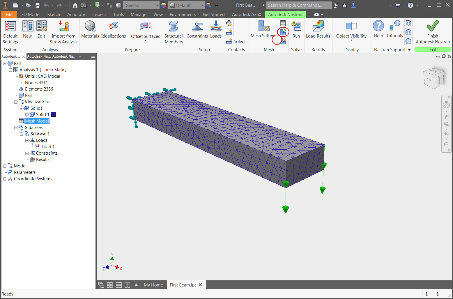

6. Mesh the Beam
  1. Click Generate Mesh from the ribbon.
The mesh generates:

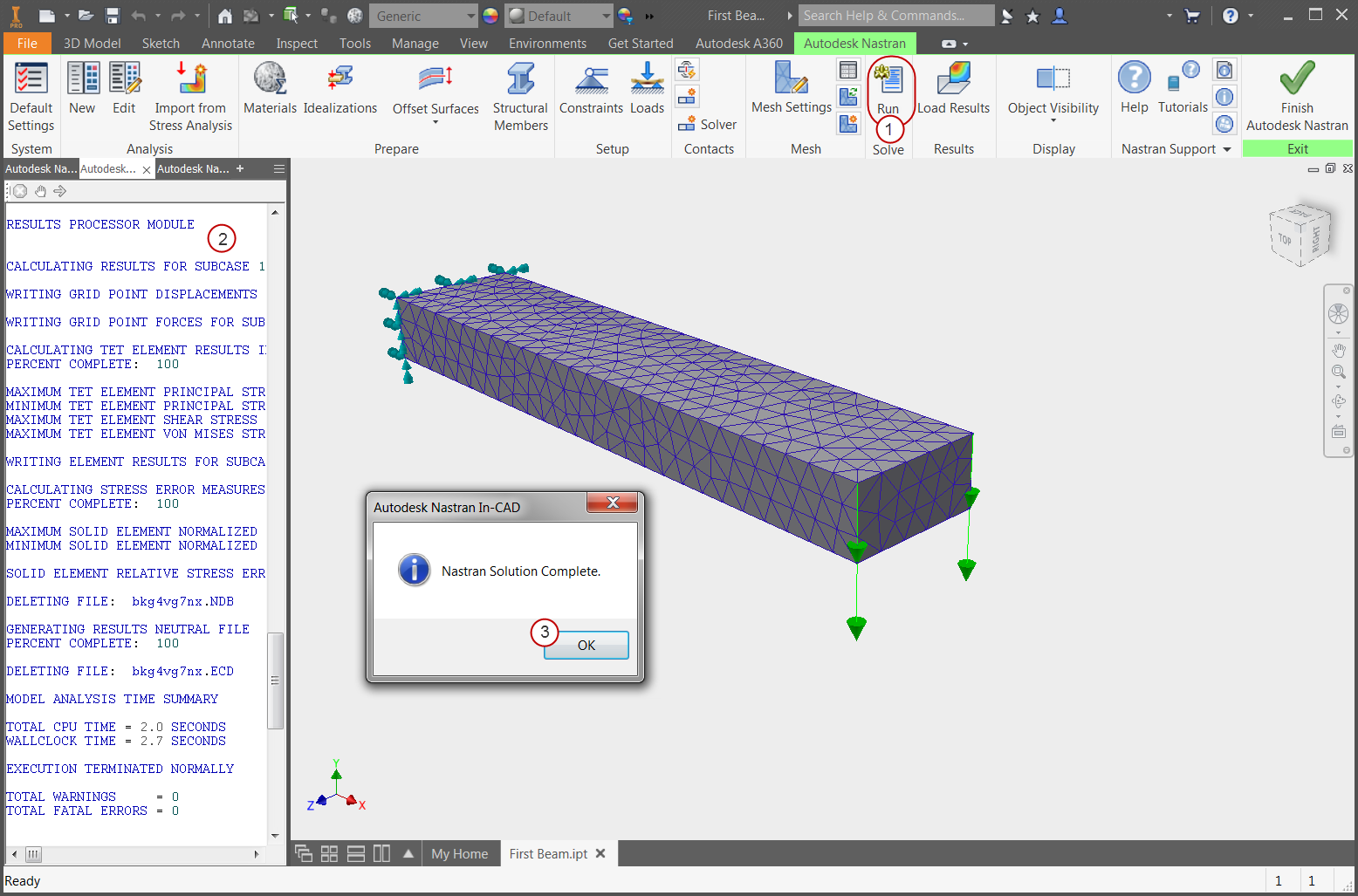

7. Run the Simulation
  1. Click Run from the ribbon.
  2. The tree automatically switches to the Autodesk Nastran output. This is a log of the solution progress.
  3. When the solution is complete, click OK.

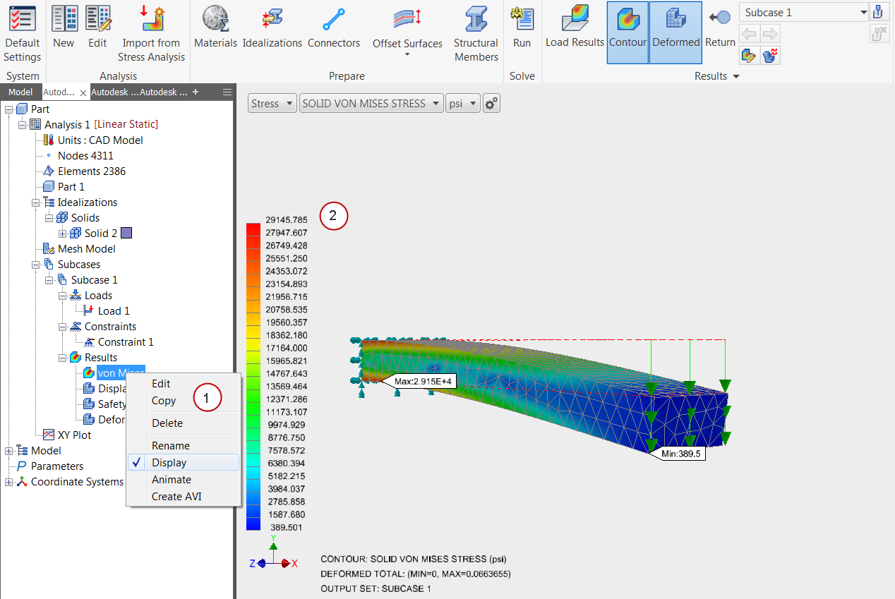

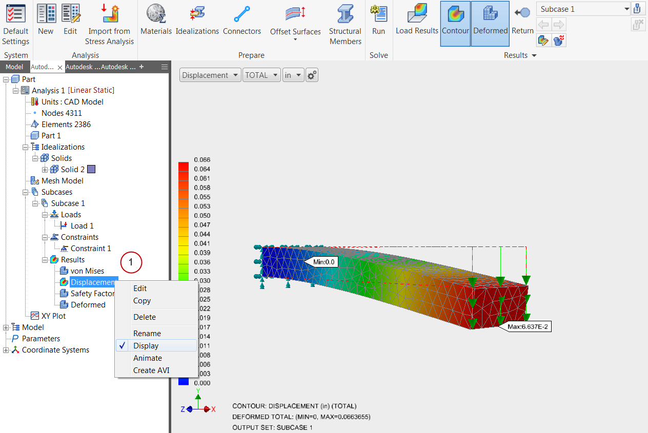

8. Visualize Displacement
  1. If the Analysis tree is not visible, click on the Autodesk Nastran Model Tree tab.
  2. Under the Results node of the tree, right-click Displacement > Display.
Note the maximum displacement of 0.066 inches.
9. Visualize Stress
  1. Under the Results node of the tree, right-click von Mises > Display.
  2. Note the maximum stress of 29,000 psi.

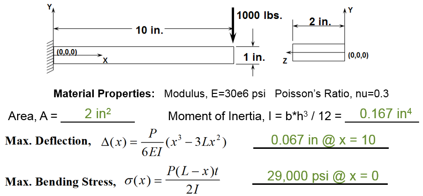

When we compute the response by hand, we find the following:
