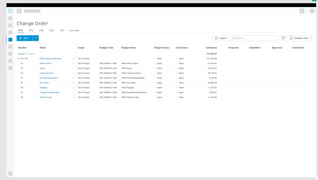

Potential Change Order Tab Overview
PCO tab overview

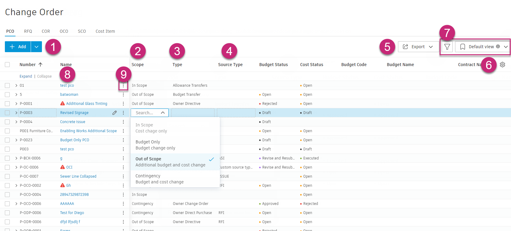

  1. Select Add to create a PCO.

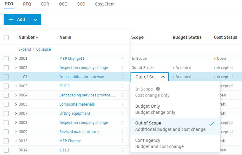

  2. Select In Scope, Budget Only, Out of Scope or Contingency to change the order's scope. When a change is budget-side only, simply do not add any values to the Estimated, Proposed or Committed columns.
  3. Type is an optional field if you’d like to number, track or group change orders by their type.
  4. Source Type and Source Ref are also optional, and you can use them to track or group based on the origin of the change.
  5. Export allows you to export a PDF or CSV PCO report.
  6. Column settings allow you to select the columns you wish to include in your view.
  7. The view selector allows you to store and recall your preferred grouping or column visibility. See the Filter and Group article to learn more.
  8. Select the PCO name to open the flyout panel. The Edit icon allows you to edit the name. Scroll down to edit the Cost Summary section, where you can edit Qty, Unit, Unit Cost and Amount for each status.

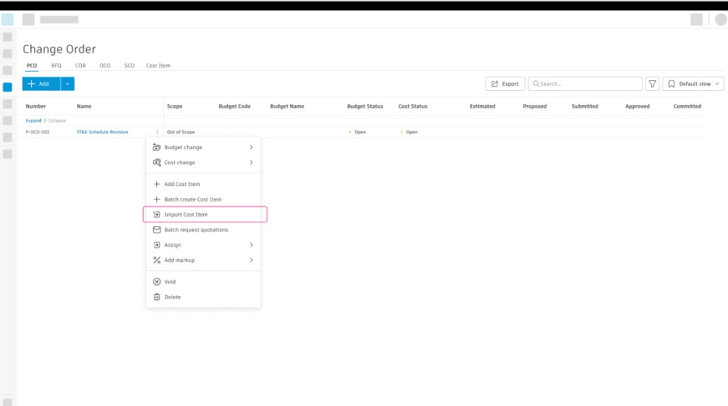

  9. Select the More menu More menu icon to add cost items, duplicate, change status and more.
    Tip: You can create up to 100 cost items at once by choosing Batch create Cost Item, or import cost items and sub-items from Excel by choosing Import Cost Item.

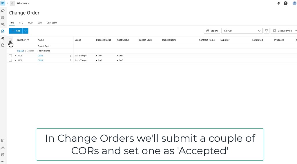

Create a Potential Change Order
A PCO is the starting point for any change order. You can create it manually in the Change Order tool or create a PCO from an RFI, Issue or Submittal Item.
To create a PCO:

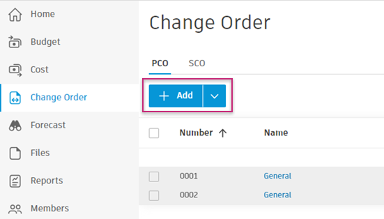

  1. Select the Change Order tool from the left navigation.
  2. Select the PCO tab.
  3. Click Add.
  4. Enter a name for the PCO.
  5. Set the Scope to In Scope, Budget Only, Out or Contingency. The scope determines where the PCO appears in the budget and contract overview. You can also change the scope on the cost item level. Choose the scope from the available options:
    • In Scope: Represents a cost-side change only, without affecting the budget.
    • Budget Only: Indicates a budget-side change only, with no cost-side impact.
    • Out of Scope: Refers to a budget-side change for items not included in the original scope. The owner will allocate extra budget through a PCO to cover the cost.
    • Contingency: Denotes a change that is out of scope funded by transferring amounts from an existing contingency budget.
    Tip: To learn more about scopes and how change orders populate in the budget and contract tables, see the Budget and Contract Tables article.

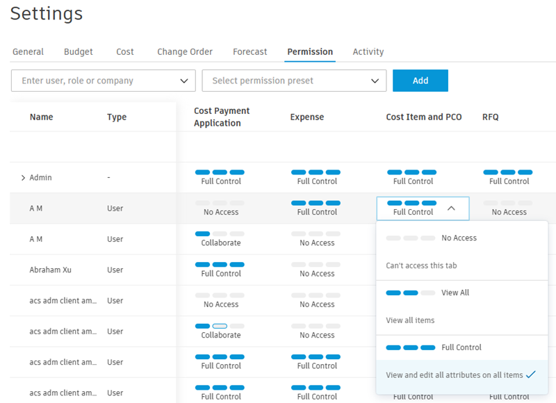

To work with this workflow, members need Full Control permission level for Cost Item and PCO in Cost Management.
Full control permission

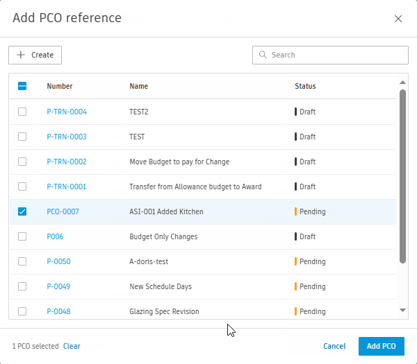

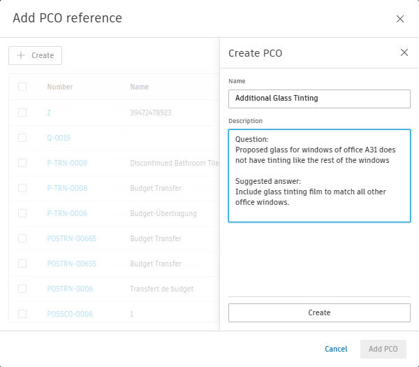

Create a PCO from an RFI, Issue or Submittal Item

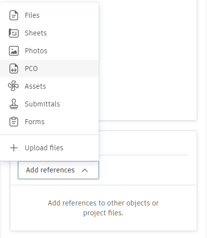

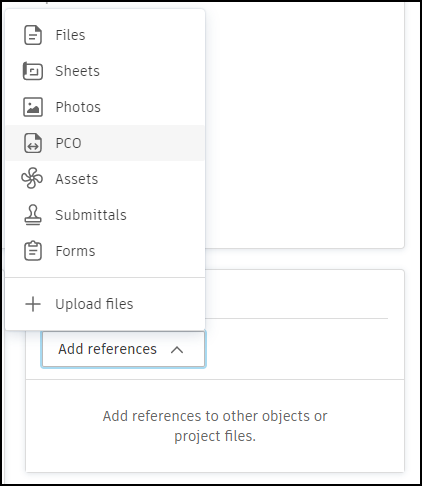

From either a new or existing RFI, Issue or Submittal item record:
  1. Scroll to References and select Add reference.
  2. Choose PCO.
    Add PCO from RFI
  3. In Add PCO Reference, select Create.
  4. Fill in the PCO name and description, then select Create.
    Add PCO reference
This information will populate the new PCO record within Cost Management, where it can be altered later.

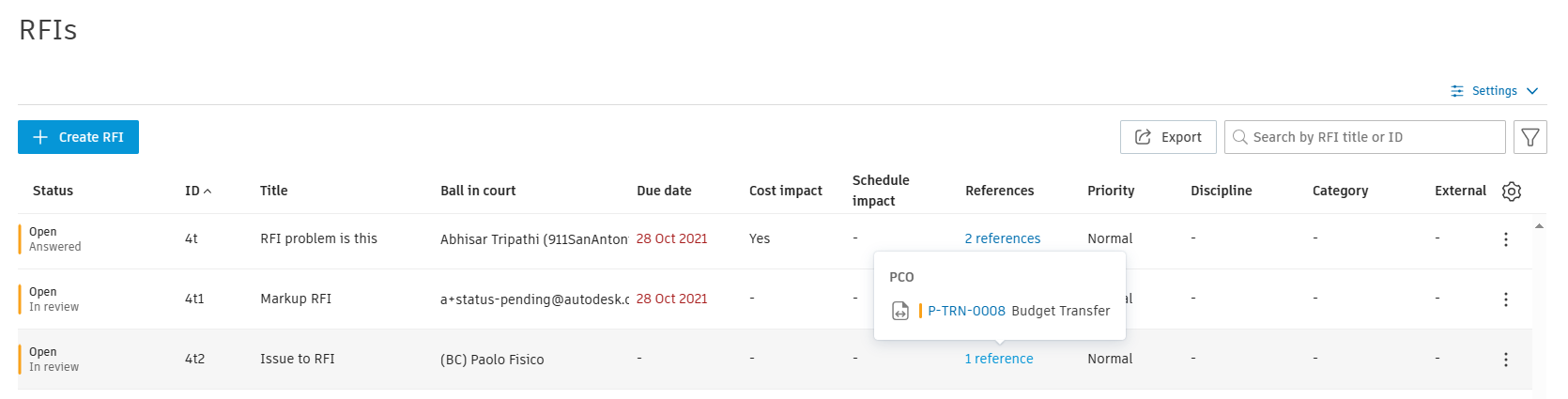

To link existing PCO(s) to project management items, follow the steps in the previous section, but instead of creating a PCO, choose the existing PCO(s) from the list and click Add PCO.
Add PCO
Within the RFI, Issue or Submittal item list view in the Linked References column, select the PCO number to open the PCO in Cost Management. If the member does not have the correct permission level, this option will not be accessible.
RFI list references

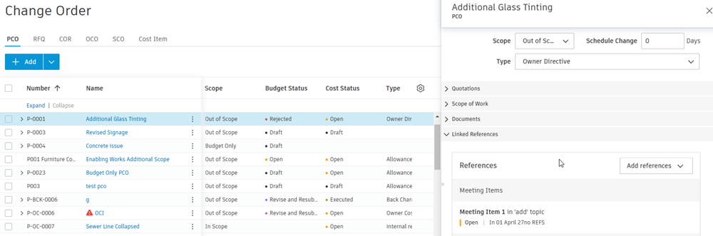

An RFI is also shown in the Linked References section in the change order's details panel when:
Linked references

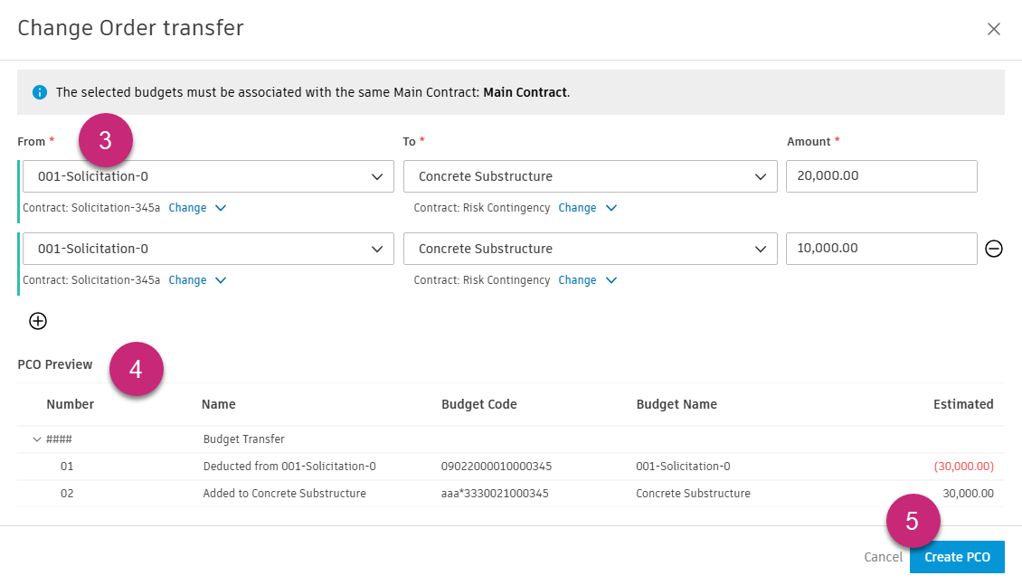

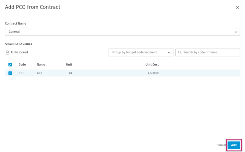

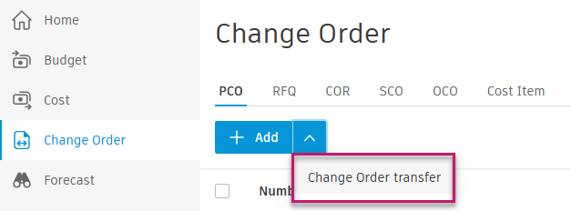

Create a PCO Through the Change Order Transfer (Collaborative PCO)
Collaborative PCO users with Collaborate permission can generate change order transfers, which are net-zero PCOs that move the budget from one item to another without changing the total budget.
To create a change order transfer:
  1. Go to the Change Order tool in Cost Management and select the PCO tab.
  2. Click Change order transfer.
  3. In Add change order transfer from Contract:
    • If your company has only one associated supplier contract, the contract field will auto-populate.
    • Use the Schedule of Values picker to select the SOV items for the transfer (only budget-associated SOV items are listed).
    • Select From and To budgets to create the transfer.
  4. Review the PCO preview showing the combination of positive and negative cost items:
    • If budgets in From and To are linked to the same contract, positive and negative cost items are combined in the same PCO.
    • If not, positive and negative cost items are placed in separate PCOs.
  5. Click Add PCO.
    Change order transfer as collaborative user
  6. Submit the change order transfer PCO through the normal PCO workflow. See Create a PCO as a Collaborative Access User for further instructions.

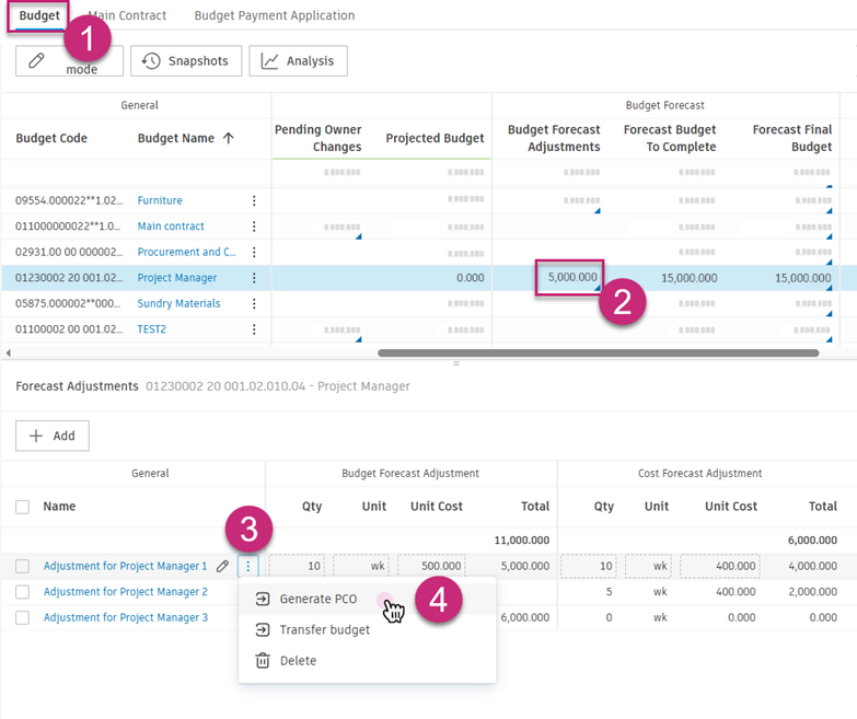

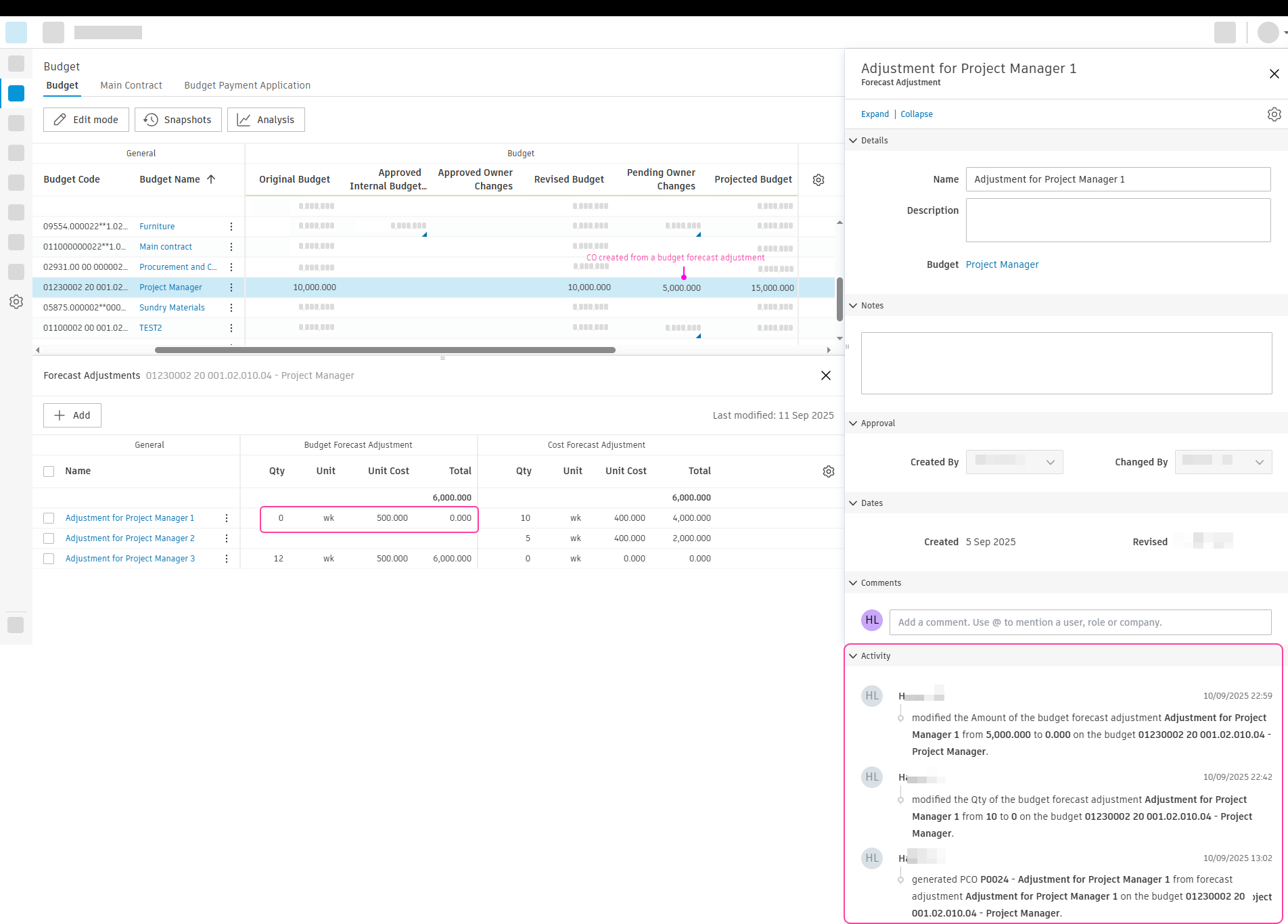

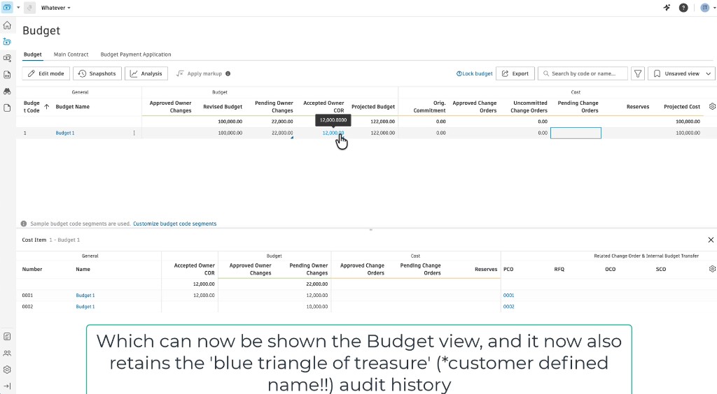

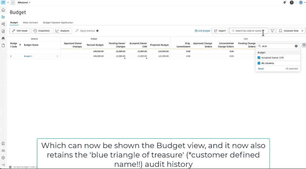

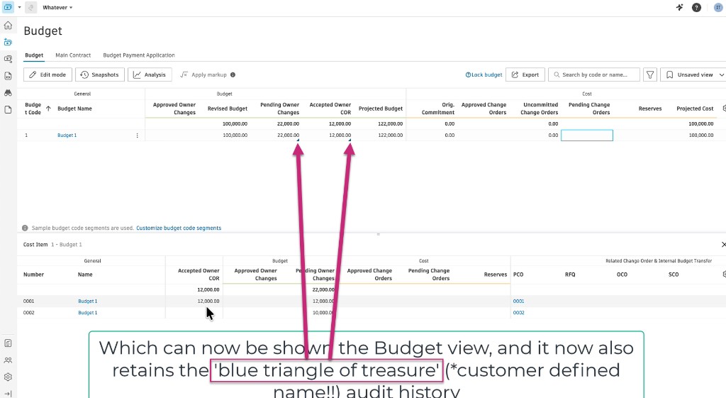

Create a PCO from Forecast Adjustment
You can create a PCO from forecast adjustment to request extra budget. This can be done when project administrator set revenue forecast.
To do so:
  1. Open the Budget tool in Cost Management.
  2. Click the blue triangle in the Budget Forecast Adjustments column in the Budget Forecast section of the table. Those are visible if revenue forecast is on. The bottom flyout opens.
  3. Click the More More menu menu next to the forecast adjustment. Tip: You can also batch create PCOs from forecast adjustments. To do so, tick all the boxes next to forecast adjustments in the bottom flyout and click Generate PCO.
  4. Choose Generate PCO.
Create PCO from forecast adjustments
Tip: Alternatively, you can follow the procedure from the details panel of the budget. To open details panel, click the budget name and scroll down to Forecast Adjustments section.
The Generate PCO window opens. You can generate from budget forecast adjustment, cost forecast adjustment or both.
Generate PCO from forecast adjustments

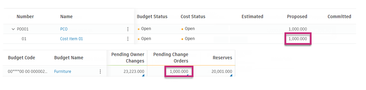

After the PCO is generated, you'll see changes in the Pending Owner Changes. If you generated from budget forecast adjustment, Budget Forecast Adjustment Qty is set to 0. As a result, Amount is also set to 0. Unit Cost is not changed. There are three activity logs after this procedure.
PCO from forecast adjustments – outcome
It's the similar rule for other options. If you generated PCO from cost forecast adjustment, you'll see changes in Cost Forecast Adjustment section and so on. If from both, you'll see changes in both places and there will be five activity logs.

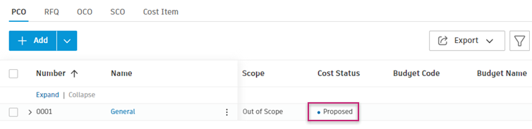

If you are a supplier with collaborative permissions and have been enabled by an administrator to create PCOs, you can submit a PCO.
Note: Make sure that the process is set correctly and that you have the proper permissions. Learn about the Setting Project Process for Downstream PCO Collaboration.
Tip: Learn more about Collaborate in Cost Management.
To create a PCO as a Collaborative Access User, follow these steps:
  1. Go to the Change Order tool in the menu. Click Add. Add Button
  2. Select the appropriate contract and choose your budget. Confirm with the Add button.
    Collaborative access contract selection
  3. Fill in the necessary fields and click Submit.
    Collaborative access submit button
    Your PCO is now proposed.
    Collaborative access proposed status
    Note: If you click Save and Close instead of Submit, the PCO will be saved as a draft (with the status Pricing). You can edit the fields later by clicking the More menu More menu icon and choosing Submit.

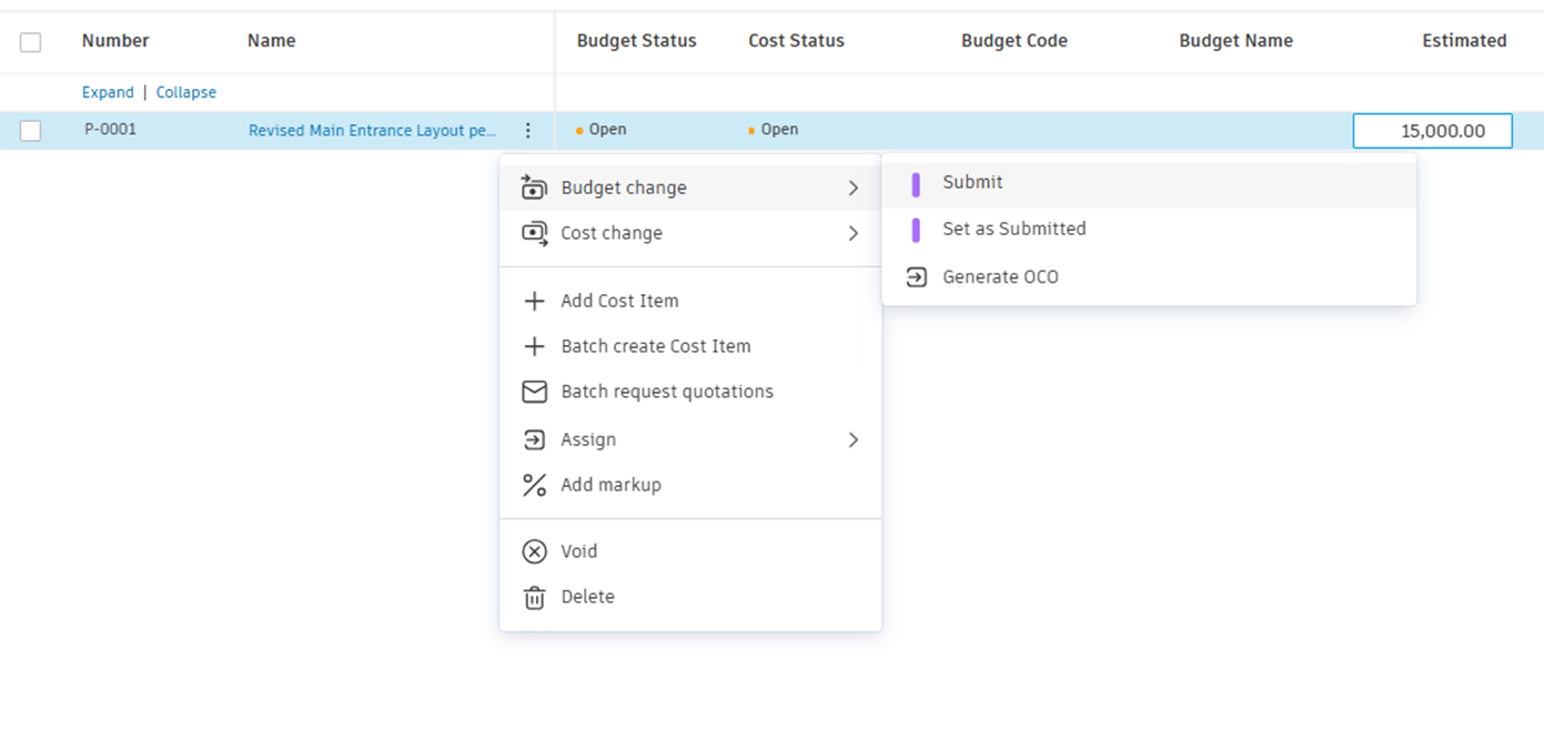

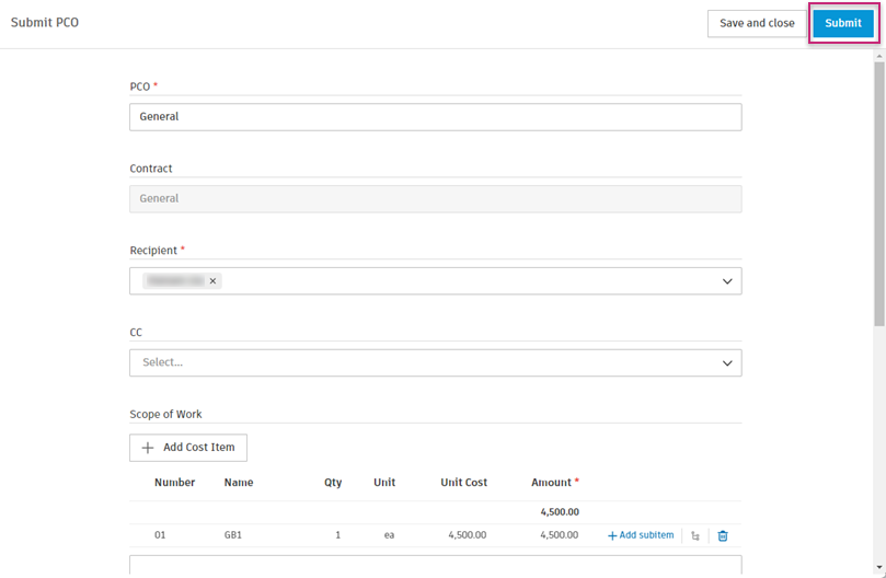

Submit PCO as COR Without Cost Items
When working with PCOs in an early estimation phase, you can submit a PCO for review without creating detailed cost items. This streamlines the workflow when you need to get budget approval quickly.

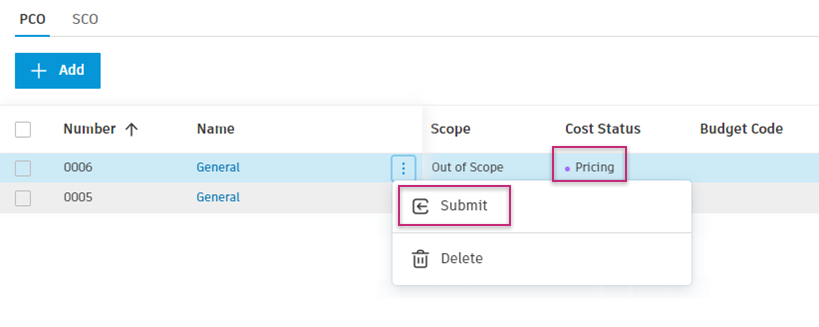

To submit a PCO without cost items:
  1. Create a PCO and enter values in the Estimated, Proposed or Submitted columns at the PCO level.
  2. Click the More menu More menu icon next to the PCO.
  3. Choose Budget Change, then Submit.
    Submit PCO without cost items
  4. If there is no Submitted value, the Submit PCO modal will only show the PCO level. Enter the Submitted value and click Submit.
    Submit PCO modal
  5. If there is a Submitted value, the PCO as COR can also be submitted with the Send for signature action. Once the document is signed and returned, PCO as COR will be automatically set as accepted.
Tip: Estimated, Proposed, Submitted columns are editable on PCO level when no cost items are attached. This allows for flexibility in the early stages of change order processing.

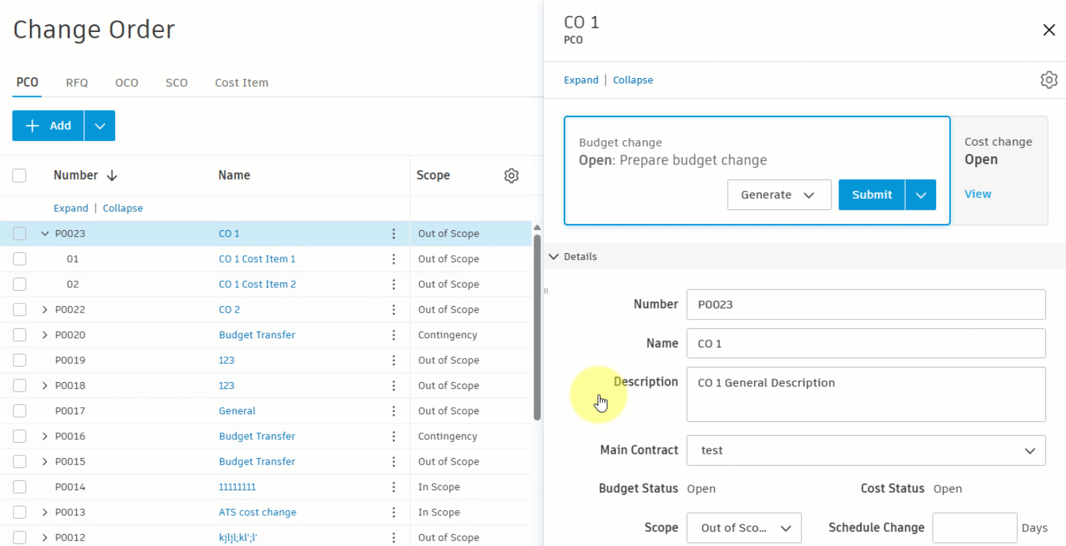

Edit Existing PCOs
After the PCO is created, you can add more or modify details. To do so:
  1. Click on the PCO name to open the details panel.
  2. Add information to the applicable fields in the Owner Details or Main Contractor Details, Recipients, Scope of Work and other sections, including:
    • Name
    • Description
    • Cost Status (learn more about change order statuses)
    • Schedule Change (impact of the PCO, as measured in the number of days the project schedule is changed)
  3. Modify any previously defined fields if necessary.
Tip: To detach a cost item from a PCO, expand the row and select the item. A detach button will appear.

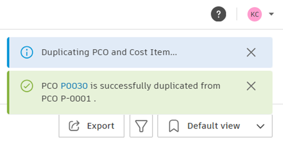

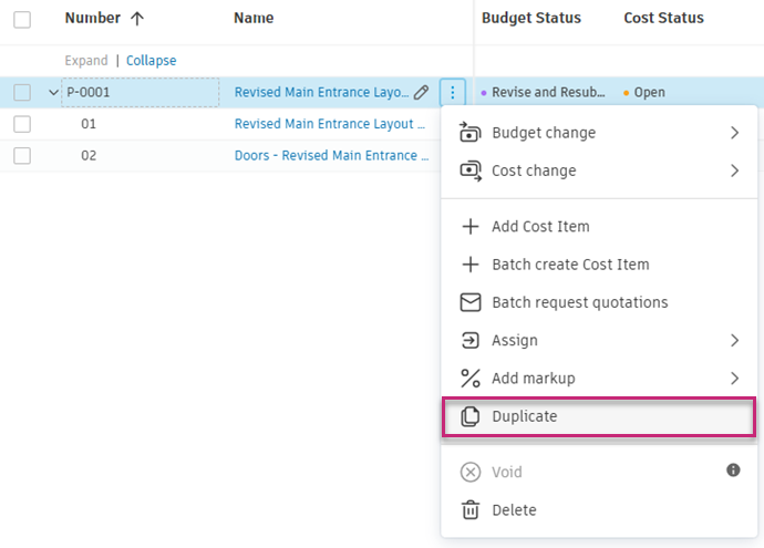

Duplicate a PCO
Duplicate an existing PCO to quickly create a PCO with similar content. This is useful when you have standard indirect budget codes required on all PCOs (like internal labour), or when you need to create multiple similar change orders.
Permissions required: Full Control permission for both PCO and Cost Item. See Cost Management Permissions to learn more.
To duplicate a PCO:
  1. Click the More menu More menu icon next to the PCO that you want to duplicate.
  2. Select Duplicate.
    Duplicate option
  3. A toast message appears to show the duplication is in progress.
  4. Once complete, a success message appears with a link to the new PCO.
    Duplication complete
The duplicated PCO includes:
The duplicated PCO does NOT include:
Note: The duplicate option is disabled if the PCO has more than 200 cost items.

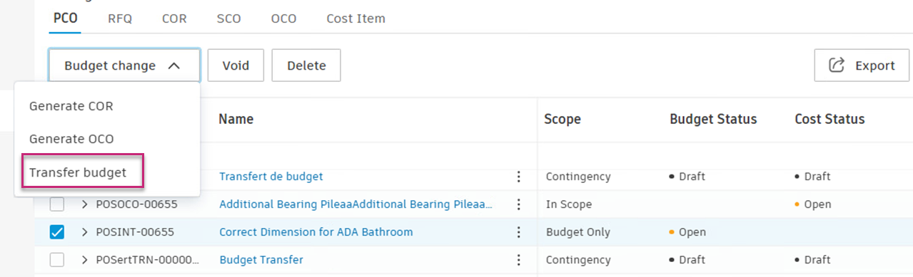

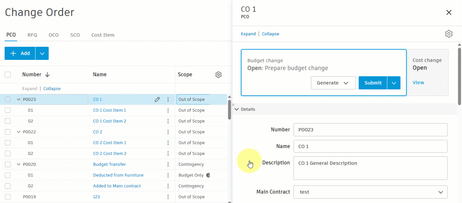

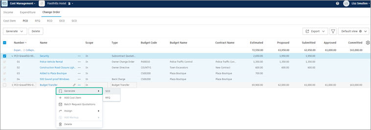

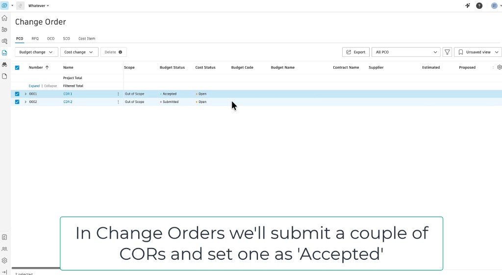

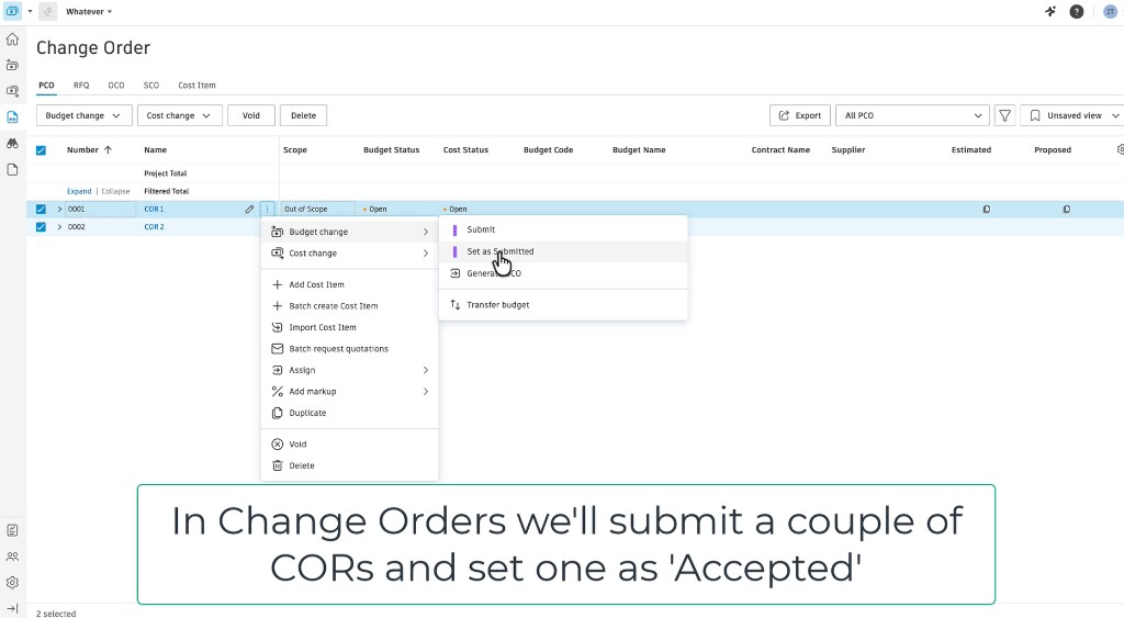

Generate Change Orders from a PCO
You can generate CORs, OCOs, SCOs and RFQs from a PCO. To do so, make sure that:
Note: For certain actions like generating change orders or applying markup, cost items are required. If you attempt these actions without cost items but with values entered at the PCO level, the system will guide you to add cost items first.
Then:
  1. Click the More menu More menu icon next to the PCO.
  2. If the scope of the PCO is:
    • In Scope – click Cost Change and choose Generate RFQ or Generate SCO.
    • Budget Only – click Budget Change to generate COR or OCO.
    • Out of Scope or Contingency – click Budget Change to generate COR or OCO and Cost Change to generate RFQ or SCO.
Cost PCO
The new change order is generated and you’ll be moved to the suitable tab to continue the workflow.

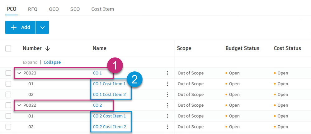

How Data Flows When Generating Change Orders from PCO
When generating change orders from a PCO, data flows through specific fields at two levels:
  1. Change Order Level: Used for general descriptions and the overall scope of work, which applies to the entire change order and all associated trades.
  2. Cost Items Level: Used for detailed descriptions and scope of work specific to individual budget codes or trades.
Example scenarios:
  1. Single PCO to OCO. If you generate one OCO from a single PCO:
    • The PCO description is copied to the OCO.
    • The scope is aggregated from the PCO and its cost items.
    Single PCO to OCO
  2. Multiple PCOs to OCO. If you generate one OCO from multiple PCOs:
    • Descriptions from all PCOs are aggregated and copied to the OCO.
    • Scopes from all PCOs and their cost items are aggregated and copied to the OCO.
This workflow reduces manual data entry and helps carry relevant details forward accurately to the appropriate levels. By following this process, you can maintain consistency and streamline the generation of change orders from PCOs.

Reconcile Pending Owner Changes in the Budget Table
When you set PCO budget statuses such as Submitted and Accepted, values roll into Pending Owner Changes in the budget overview. The default roll-up includes pre-submitted and submitted owner changes across scope.
The system Pending Owner Changes column shows the full pending total. A custom column such as Accepted Owner COR shows a filtered subset – for example, only Accepted owner changes. To show only Accepted owner changes in a separate budget column, an administrator first configures Manage columns in Settings. See Example: Reconcile pending owner changes with a custom column in Create Custom Columns for how to duplicate Pending Owner Changes, create custom project values and save an Accepted Owner COR column.
Submit and accept PCO budget statuses
Create or update potential change orders (PCOs) so budget statuses reflect your reconciliation scenario.
  1. Go to the Change Order tool and select PCO.
  2. Add PCOs (for example, COR 1 and COR 2) with the scope and values you want to track.
    PCO tab with two draft COR records
  3. Select the PCOs, open the More menu More menu icon, choose Budget change, then Set as Submitted.
    PCO More menu with Budget change and Set as Submitted options
  4. Set one PCO Budget Status to Accepted and leave others at Submitted (or your target statuses) using Budget change.
    PCO list with COR 1 Accepted and COR 2 Submitted budget statuses
Compare pending and accepted totals
After PCO statuses are set, compare totals in the Budget tool:
  1. Click the column settings icon and show your Accepted Owner COR column in the Budget group.
    Budget column settings with Accepted Owner COR selected to show in the table
  2. Compare Pending Owner Changes (full pending total) with Accepted Owner COR (accepted subset).
    Budget table showing Pending Owner Changes and Accepted Owner COR values side by side
  3. Click a cell with the audit history indicator (blue triangle) to open the cell details panel. Review linked cost items and PCOs.
    Budget cell details panel showing PCO links and audit history for pending and accepted owner change columns
Tip: Custom columns that use project values can show the audit history indicator when cell details are available. The flyout helps you compare change orders included in Pending Owner Changes with your custom Accepted Owner COR column. See View connected change orders in Work with Budgets.
Create an Internal Budget Transfer from PCO
Project administrators and members with both Budget and SCO full control permissions can create internal budget transfers directly from PCOs. This is useful when you need to move money from one budget item to another to pay for change orders without requiring extra approvals.
Tip: You can also create budget transfers directly from the Budget tool or from forecast adjustments.
To create a budget transfer from a PCO:
  1. Go to the Change Order tool and select the PCO tab.
  2. You can create a budget transfer in several ways:
    • From a PCO: Click the More menu Vertical more menu icon next to the PCO, click Budget change and select Transfer budget.
    • From multiple items: Select multiple PCOs or cost items, then click Transfer budget in the batch actions.
    Batch transfer budget example
  3. Then, in Internal budget transfer:
    • Each selected cost item with a non-zero Committed value creates one transfer line.
    • For positive Committed values (money allocated), the system automatically uses the cost item's linked budget in the To field.
    • For negative Committed values (money being removed), the system automatically uses the cost item's linked budget in the From field.
    • The Amount is automatically set to the absolute value of the Committed amount.
    • A note is automatically added referencing the source cost item.
  4. Click Add Icon to add more transfers, even those that are not linked to the cost items. Those transfers are separated in the table.
  5. Click Delete Icon to delete a transfer from the list.
  6. You can use Copy to all "From" or Copy to all "To" buttons to quickly populate all transfer lines with the same budget.
    Copy to all "From" buttons example
  7. Click Save to create one or more internal budget transfers.
You'll receive confirmation that the budget transfer was completed.
Generate a Contract from a PCO
Before generating a contract, make sure that:
Then:
  2. Choose Cost Change.
  3. Click Generate Contract.
  4. Enter Contract Code and Contract Name. If the foreign currency setting is enabled in your project, you'll see the Currency and Exchange Rate fields as well.
    • Choose the currency for your new contract.
    • Edit the exchange rate if needed. The default exchange rate is fetched from the settings.
  5. Enter the committed value or copy it from the cost item. If the foreign currency setting is on, the Converted icon icon shows the converted value.
  6. Click Generate.
Tip: Contract schedule of values will be generated from the Committed value and its breakdown of each Cost Item. If all cost items of a PCO have a status of Contracted or Approved, PCO cost status will move to Approved.

  3. Click the More menu More menu icon of the PCO that you want to add markup formula to.
  4. Go to Add Markup and select the financial markup formula to use.
Expand the PCO to see that the financial markup is added to the PCO.

Import Cost Items From a Spreadsheet
You can import cost items and sub-items into an existing PCO from an Excel spreadsheet instead of adding them one at a time. Create the PCO manually first, then import the cost breakdown.
You need Full Control permission for PCO and Cost Item to import cost items. Members with collaborative access and PCO create permission can also use this workflow.

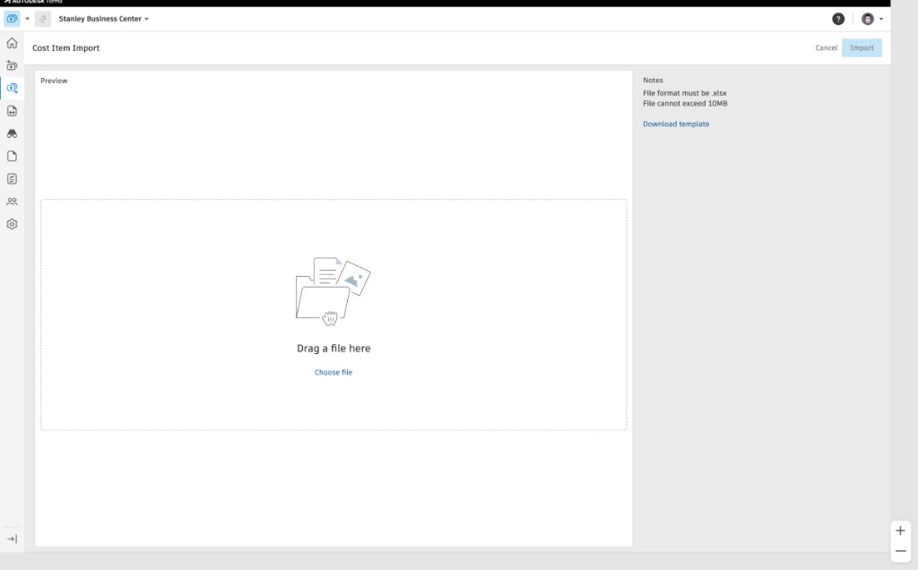

To import cost items into a PCO:
  3. Create a PCO or open an existing one.
  4. Click the More menu More menu icon on the PCO row and select Import Cost Item.
    PCO More menu showing Import Cost Item option
  5. On the Cost Item Import page, click Download template in the Notes panel.
  6. Fill in the template with cost items, sub-items, budget codes and estimated amounts. See Prepare the cost item import spreadsheet for formatting rules.
  7. Drag a file into the preview area or click Choose file to select your spreadsheet.
    Cost Item Import page with drag-and-drop area, Download template link and file requirements
    Note: The file must be in .xlsx format and cannot exceed 10 MB.
  8. Click Import.
Imported cost items and sub-items appear under the PCO. Amounts populate the Estimated column only. Update Proposed, Submitted, Approved and Committed values through the normal change order workflow.
PCO table showing imported cost items, sub-items, budget codes and estimated amounts
Tip: You can import up to 200 cost items and 1,000 total lines per import. For larger datasets, import in batches.

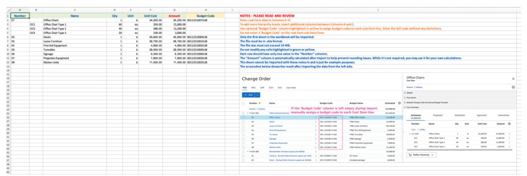

Prepare the Cost Item Import Spreadsheet
The template includes example data and formatting rules in the Notes section.
Excel cost item import template showing columns, hierarchy example and formatting notes
Before you import:
Note: Do not modify cells highlighted in green (headers) or yellow (Budget Code header). The system recalculates Amount and Unit Cost on import to prevent rounding discrepancies. Cost item numbers are imported exactly as entered, regardless of number-formatting project settings. Duplicated cost items are allowed. Markup cost items, status values and Proposed, Submitted, Approved or Committed amounts cannot be imported.
If you leave the Budget Code column empty for a cost item, manually assign a budget code to that line after import.
Automatic Budget Code Linking
When you include budget codes in the import spreadsheet, the system automatically links each budget code to the corresponding cost item during import.
To use automatic budget code linking:
  1. Download the cost item import template from the Cost Item Import page.
  2. Fill in the Budget Code column for each parent cost item row in your spreadsheet.
  3. Import the completed spreadsheet.
The system matches each budget code to the appropriate cost item. After import, you can verify the budget code associations in the PCO table or cost item details panel.
