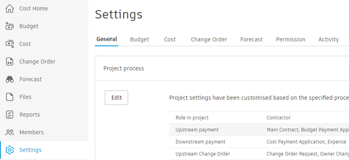

  1. Select the Settings tool from the left navigation.
  2. Switch to the General tab.
  3. Select the Project Process drop-down list.

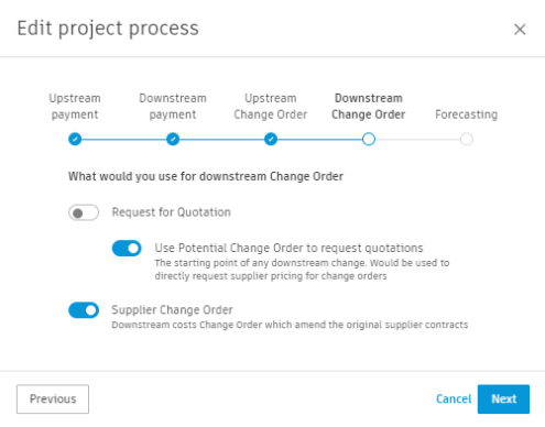

  5. Go to the Downstream Change Order section by clicking Next.
  6. Disable the Request for Quotation option. Then enable the Use Potential Change Order to Request Quotations option.
    Downstream Change Order section showing PCO as RFQ option enabled
  7. Click Next until you can click Save.

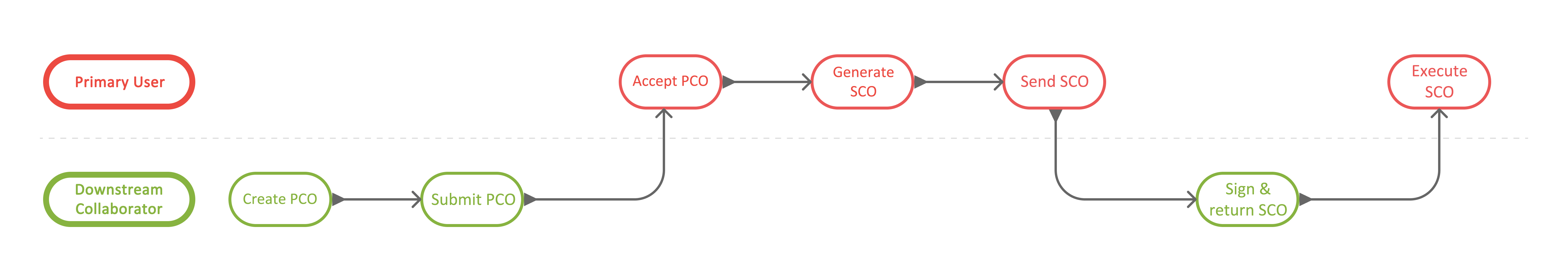

Once the project process and permissions are set, suppliers as collaborators can work with general contractors on the downstream collaborative PCO workflow.

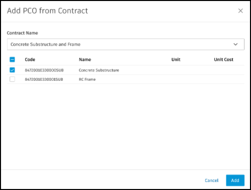

When you want to create a PCO as a supplier:
  1. In the Change Order tool from the left navigation, select the PCO tab.
  2. Click Add. The pop-up window Add PCO from Contract shows.
  3. Select the Contract Name and Contract SOVs.
    Add PCO from Contract dialog window showing contract selection options
  4. Click Add. The PCO is created and the Submit PCO panel opens.
    • Add a name for the PCO request.
    • The default recipient of the PCO is a general contractor. Choose more recipients of an email copy to a general contractor, if necessary. Learn more about company setup.

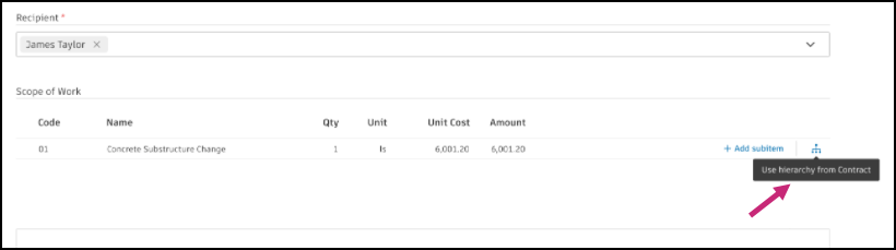

    Tip: To see cost items' breakdown, use the contract hierarchy button.
    Contract hierarchy button interface showing cost items breakdown
  5. Click Submit. The PCO receives the Proposed status.
Note: If a project administrator has configured a PCO supplier quotation approval workflow, the PCO is reviewed internally before moving to Accepted, and the Proposed status is skipped. See Approval Workflows.
Now, a contractor receives the email notification and can open the change request in Cost Management.

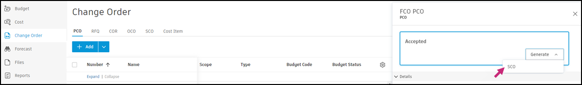

After acceptance, a confirmation message is sent to a supplier.
As a general contractor, you can now generate a Subcontractor Change Order (SCO) to proceed with the change order workflow. To learn more about creating change orders, see the Change Order Requests article.
Generate SCO button and interface for creating Subcontractor Change Orders

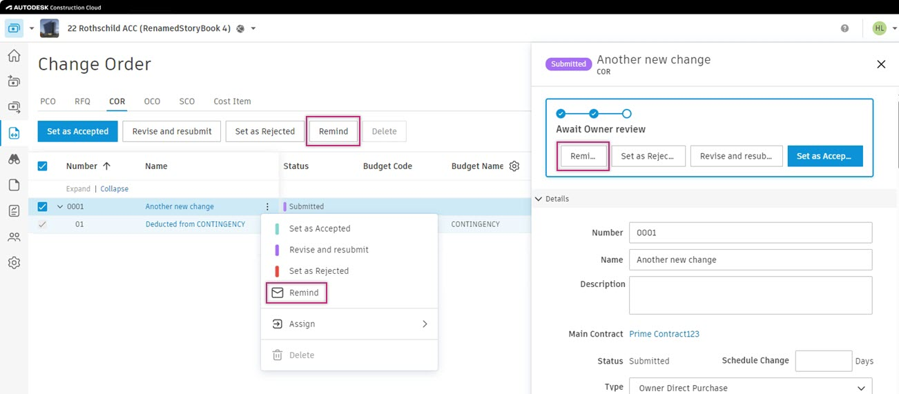

Tip: Administrators can send a reminder to the supplier or owner to inform them that a response is awaited.
To do that, click Remind. This option is available when:

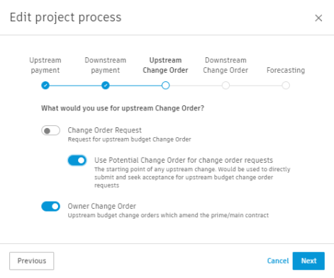

  5. Go to the Upstream Change Order section by clicking Next.
  6. Disable the Change Order Request option. Then enable the Use Potential Change Order for Change Order Request option.
    Upstream Change Order section showing PCO as Change Order Request option enabled

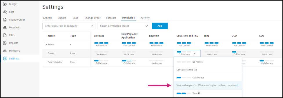

Setting Permissions for Upstream PCO Collaboration
The upstream collaborative PCO workflow requests certain permissions. To do so:

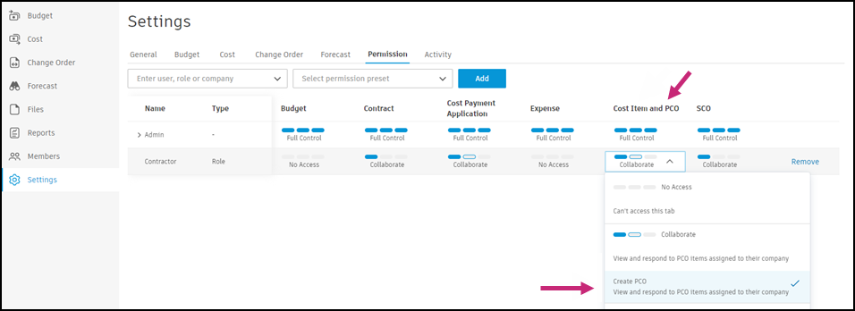

  2. Switch to the Permission tab.
  3. Choose the Collaborate on Upstream Change permission for the Owner role.
    Permission settings showing Collaborate on Upstream Change permission for Owner role

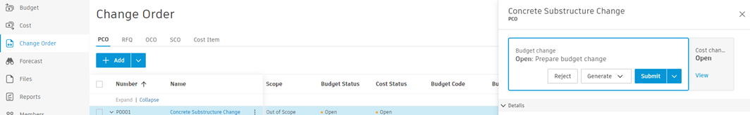

To send PCO as RFQ:
  2. Create a PCO. See the Potential Change Orders article for more information.
    PCO creation interface from the Change Order tab

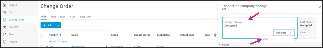

  3. Click Generate in the Cost Change window. Select RFQ.
  4. Send an RFQ to a main contractor/owner and other recipients, if necessary. The main contractor/owner contact from PCO flyout is the default recipient of an email. You can change the company setup in the Settings tool. Once a main contractor/owner receives a proposed price, they can review it and accept. In the Cost Change window, an RFQ receives the Accepted status.
    Cost Change window showing RFQ with Accepted status

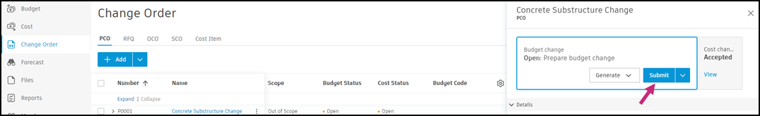

  5. Click Submit in the Budget Change window. The pop-up window opens.
    Submit Budget Change dialog window for entering submitted values
  6. In the pop-up window, enter the submitted value and then click Submit.
  7. Prepare an email to an owner and then click Send. In the Budget Change window, the status changes to Submitted.

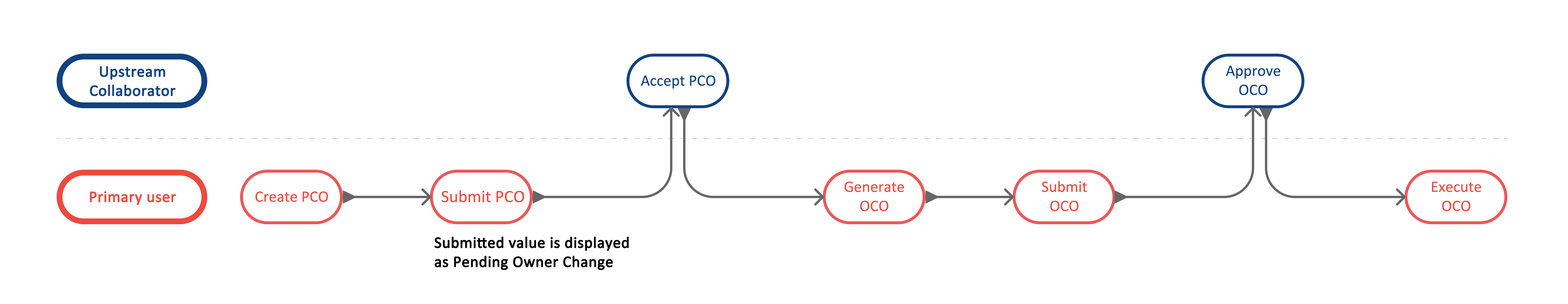

In the next steps of the workflow, a main contractor/owner:
  1. Receives the email notification.
  2. Opens the PCO in Cost Management.
  3. Reviews the change request and decides to accept it or not.

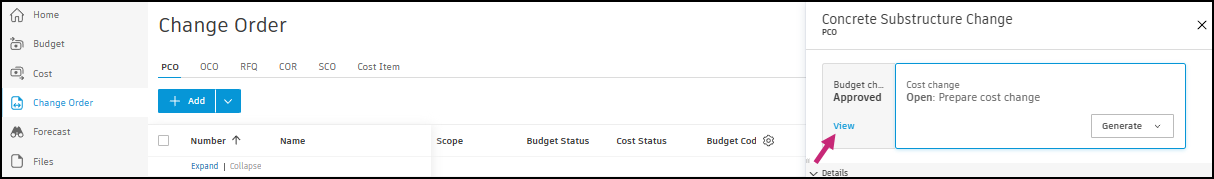

Once accepted, a contractor receives a confirmation email and can generate an Owner Change Order (OCO). To learn more about creating change orders, see the CORs, OCOs and SCOs article. Generate OCO button and interface for creating Owner Change Orders When a change order is in the Approved or Executed status, an owner can read cost information or download documents in the view-only details panel. Click View Cost Detail in the More menu Vertical more menu icon.
View Cost Detail option in the More menu for owner access to cost information
