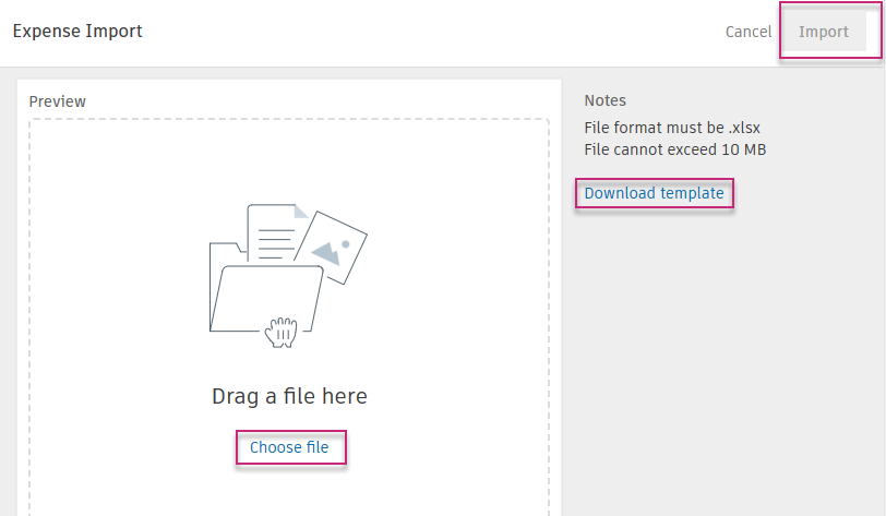

Add Expenses From a Spreadsheet
To add a list of expenses from an existing spreadsheet:
  1. In the Cost tool, select the Expense tab.
  2. Click .
  3. Choose an Excel file to be imported.
    Note: You can use the example template to learn the correct formatting.
  4. Click Import and then Done.

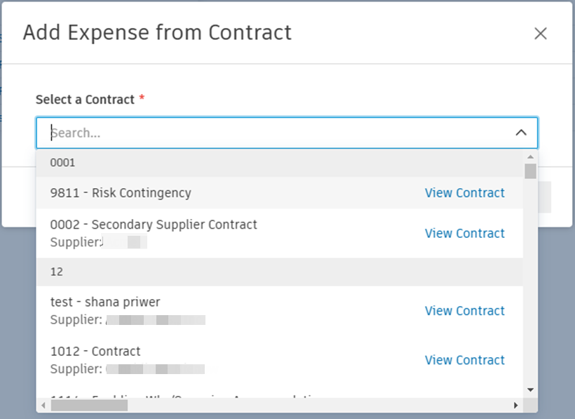

Add Expenses From an Existing Contract
To add expenses from an existing contract:
  2. Click Add from Contract.
  3. Select a contract with the drop-down list and click Add.
  4. Fill in the following fields:

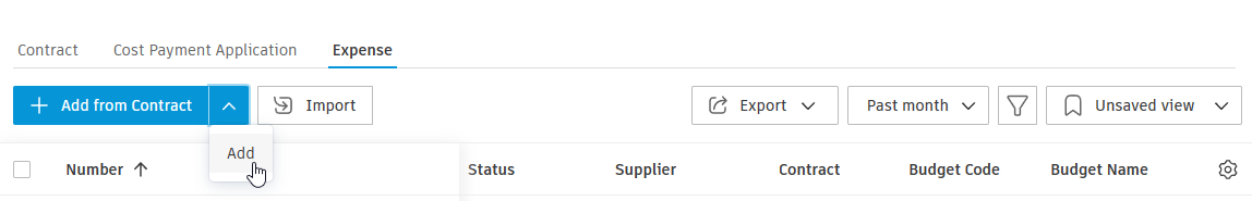

Add Expenses Manually
You can add expenses manually. To do so:
  1. Navigate to the Expense tab (described in the previous example).
  2. Select Add in the drop-down list.
  3. Enter the following information:

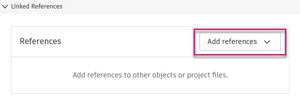

Add Expense Photo References
Use the photo reference capability for expenses to ensure supplemental information such as delivery tickets or receipts are available to process payments.
To add a photo reference:
  1. Within the Cost tool in Cost Management, navigate to the Expense tab.
  2. Select an expense item to open the flyout panel, scroll to the Linked References section and select Add References.

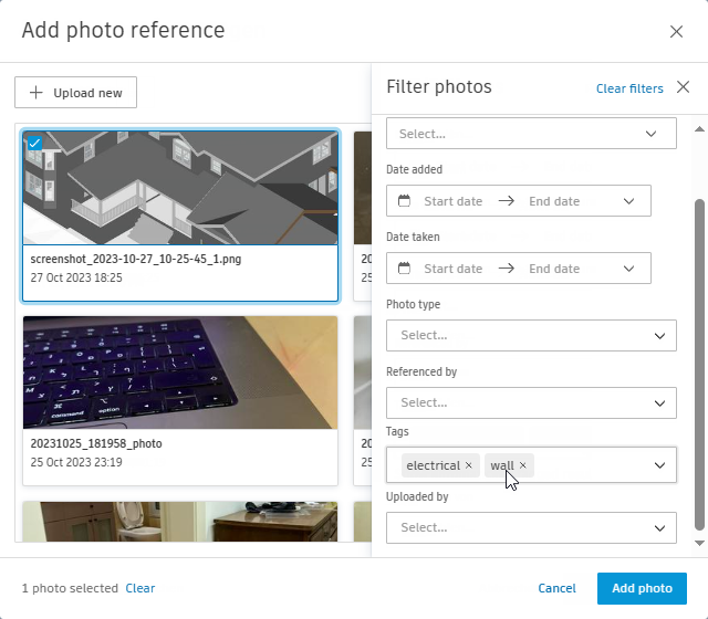

  3. Existing photos from the Photos tool in Autodesk Build will appear in the Add Photo Reference window. To upload a new photo, select Upload New.
  4. Choose the files from your desktop or drag and drop.
  5. Select Upload, and then Add Photo.
You can use filter to quickly find specific photos. Select the funnel icon to access filters including location, date added or taken, photo type, referenced by, tags, and uploaded by.

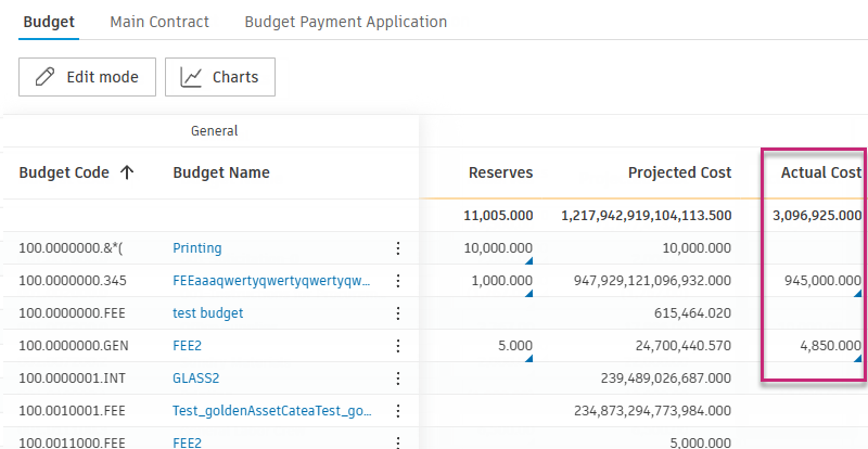

View Expense Details in the Budget Summary

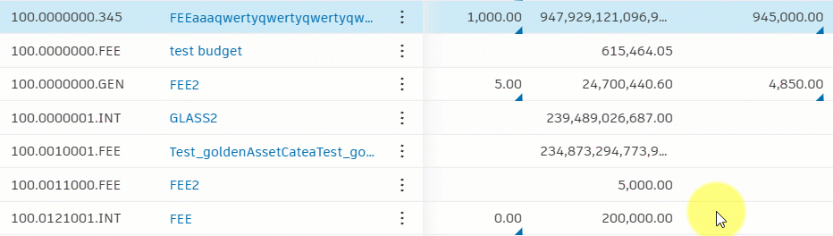

Similar to approved cost payment application details pulling into the budget summary, approved or paid expenses automatically pull into the budget summary view, giving you the ability to view actual cost breakdowns and make accurate forecast adjustments.
To see the expense details in the Budget table:
  1. In the Budget tool, navigate to the Budget tab.
  2. Scroll to the Actual Cost column. Expenses with an approved or paid status will be displayed in the list.
  3. Select the total in the Actual Cost column to view the cost breakdown.
  4. Click the budget name to open the flyout panel for more detailed information.

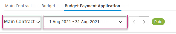

  1. Select the Budget tool.
  2. Select the Budget Payment Application tab.
  3. Use the contract and date drop-down lists to navigate to the appropriate budget payment application.

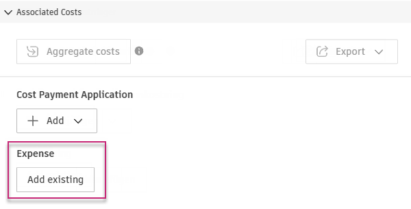

  4. Select the main contract name to open the details panel.
  5. Click Add existing in the Associated Expense section.
  6. Select the appropriate expenses to associate.
  7. Click Add.
