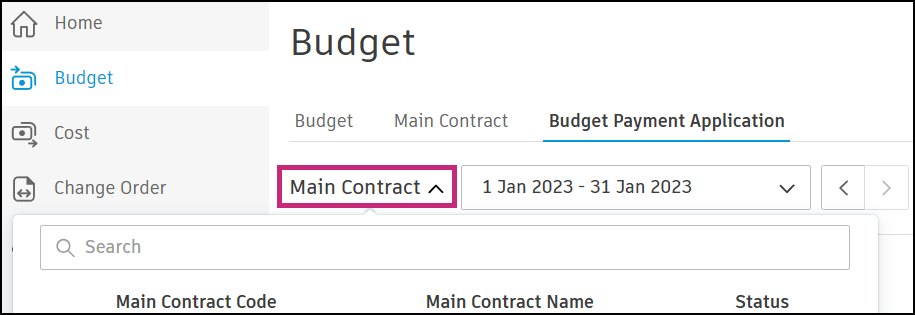

  1. Select the Budget tool from the left navigation.
  2. Switch to the Budget Payment Application tab.
  3. Once a billing period is activated, you can click Create Payment Application.
  4. Select the main contract by using the drop-down menu.

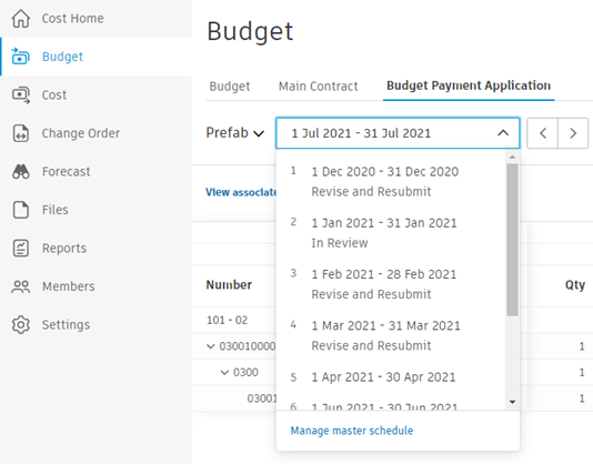

  5. Select the correct billing period or use the arrows to navigate between periods.

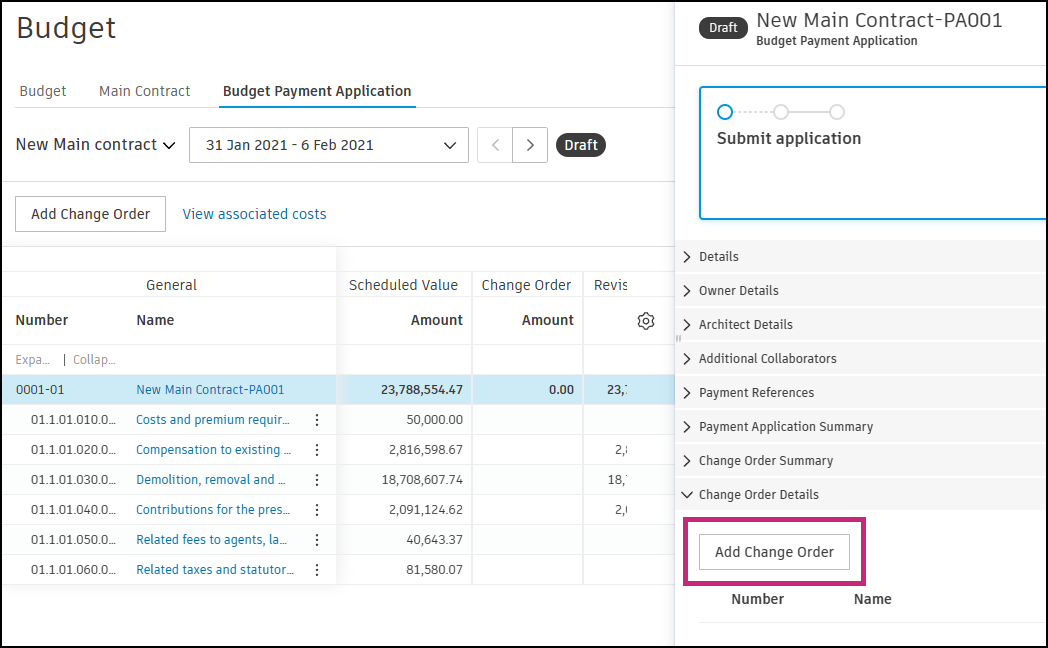

After creating a budget payment application, you can add any necessary documents or associated costs. To do that, click View Associated Costs. The details panel opens. In the Associated Costs section, you can adjust your budget payment application before sending it to an owner. You can:
Tip: You can also update the main contract SOVs at this stage. For example, you can add more budget lines. Make sure that the main contract is unlocked. See the Main Contract article to learn more.

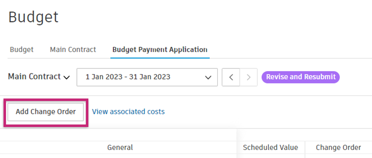

  1. Navigate to the Budget Payment Application tab and click the Add Change Order button.

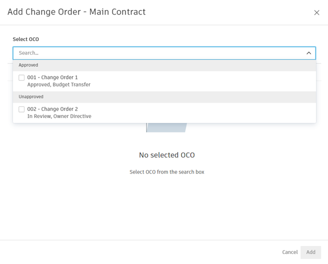

    If there are OCOs available, they will be grouped into Approved and Unapproved sections.
    • The Approved section displays items that have Approved and Executed statuses
    • The Unapproved section displays items that have Open, Submitted, Revise and Resubmit, and In Review statuses
  2. Select the items you wish to add, and click Add.

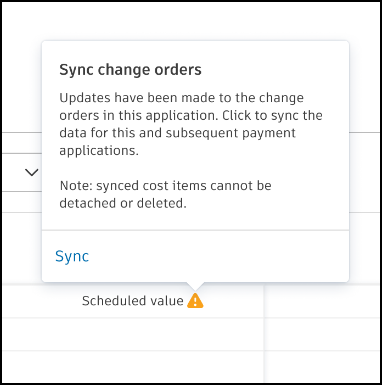

  3. After adding unapproved OCOs, you will be asked to synchronise change orders. To do that, click Sync.
    Note: Synchronised cost items cannot be detached or deleted.

Tip: You can request a revision from an owner. The payment application receives the Revise and Resubmit status.
