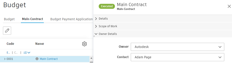

Owner Access to Main Contract

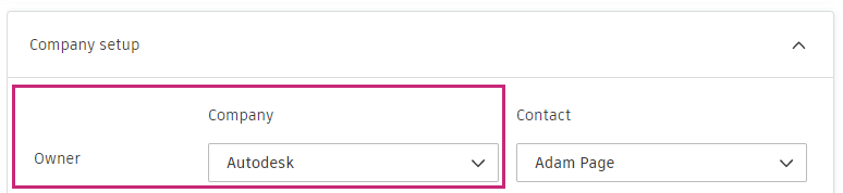

To give owners collaborative access for document uploads:
  1. Go to the Settings tool.
  2. Scroll down to the Company Setup section.
  3. Select company and contact for the owner role.
  4. In the main contract's flyout panel, assign the correct owner in Owner Details.
Owners with collaborative permission can view contract details in the Main Contract table and upload documents to the Attachment section. Access to individual SOV item links is restricted.

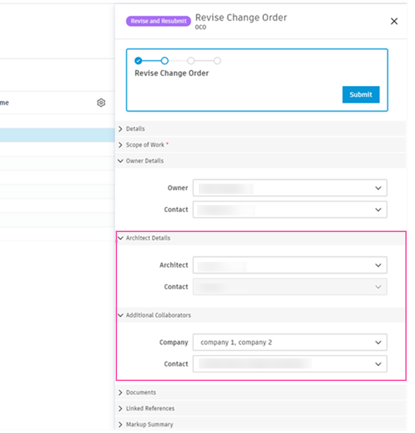

  2. Manual Review Process:
    • Grant collaborate permissions to external companies in Settings
    • Select external architect in Architect Details for COR/OCO approval requests
    • Add external reviewers in the Additional Collaborators section outside the workflow engine

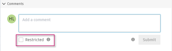

Restricted Comments
Control comment visibility with restricted comments:
Users with Full Control/Admin permissions see a Restricted tick box. Tick the box to make the comment private to internal team members only.
Note: Comments are limited to a maximum of 1,000 characters.

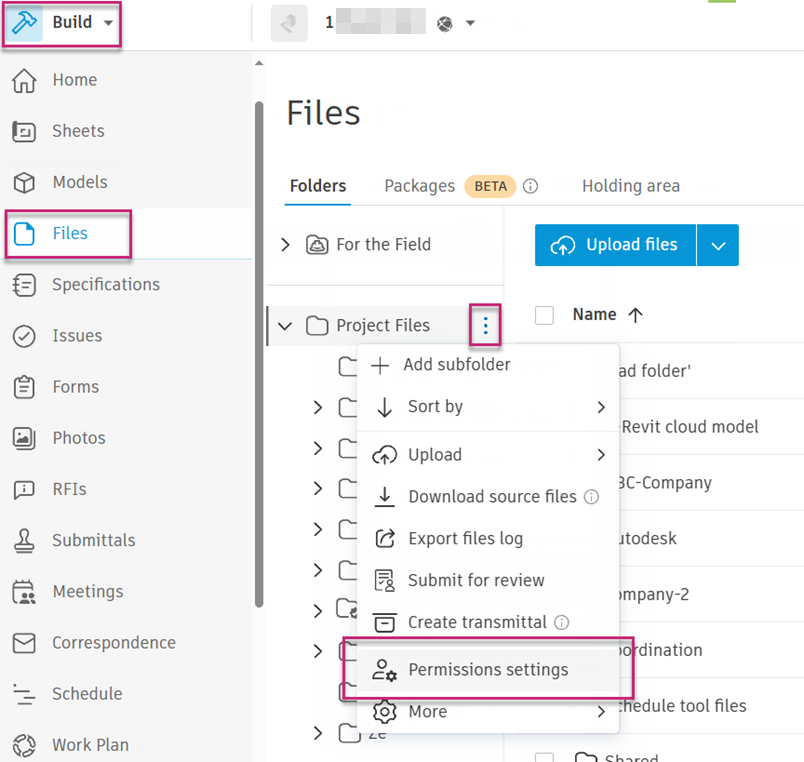

Setting Up Folder Permissions
To configure file permissions for collaborators:
  1. Select Build from the product picker, then open the Files tool.
  2. Click the More menu next to the desired folder.
  3. Select Permissions settings.

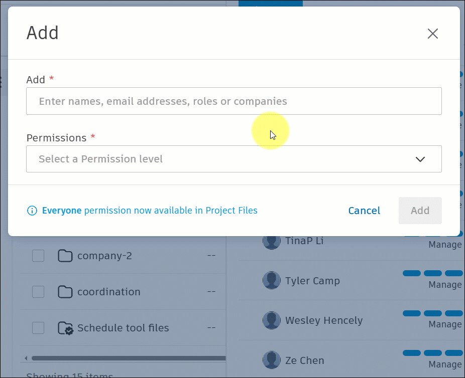

  4. In the Permissions flyout panel, click Add.
  5. Search by name, email, role or company.
  6. Choose the appropriate permission level from the drop-down.
  7. Click Add.
